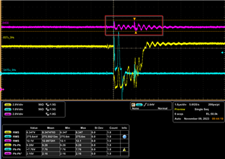

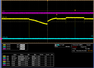

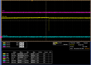

I'm using DRV8300DRGER as gate driver for inverter subcircuit of my BLDC motor controller with 3 pairs of IAUC41N06S5N102ATMA1 N-MOSFETs
I am experiencing some strange issues. I have attached a portion of the schematic and a screenshot from the oscilloscope for reference.
Specifically for 4 channel scope, only two phases have been measured, when driving the IC on Input A and B with low and high sides of the half bridge for BLDC, only the low side of the half bridge gate driving voltage corresponds with the PWM signal from the MCU. The yellow and blue waveforms on the screen (gate a and b on high side of the bridge) are being driven by the DRV8300, but they are not corresponding with the PWM output from the microcontroller. I have tested the code with a different design of the half bridge and it is commutating the BLDC motor without any problems.
The circuit is being tested with a Macon ec max motor and commutation is based on the delivered commutation table and hall sensor input. The PWM is created by an ESP32 WROOM 32E and directly connected to the corresponding inputs of the DRV8300 IC. During the measurement, no additional resistor for dead time was inserted, and standard time was used. No high consumption of the gate driver has been observed, and two replacements of the IC have been retested with the same results. The layout of the PCB and schematic is according to the first release of the datasheet.
For reference, the yellow line of the screencapture represents GHA, the blue line represents GHB, the purple line represents GLA, and the green line represents GLB. Additionally, corresponding PWM signals were captured using digital channels of the scope and an offset has been applied to correspond with phases.
If anyone has any additional information or suggestions, please let me know. Thank you.

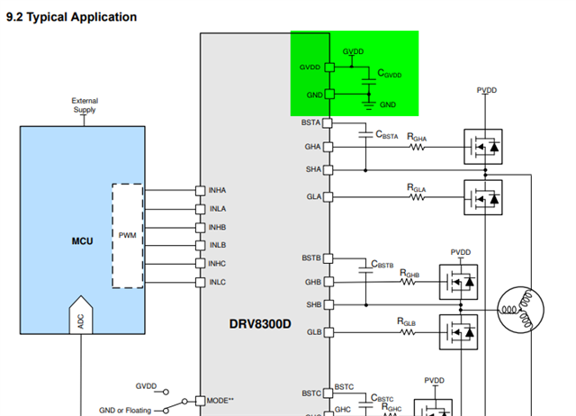

    The driver you are using has an inverted and non-inverted mode. Based off the schematic I see that MODE pin is floating meaning you are operating in non-inverted mode, is this the mode you are intending to operate in?
    Can you please show input of the same phase you're seeing this unexcepted output?

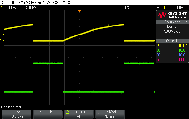

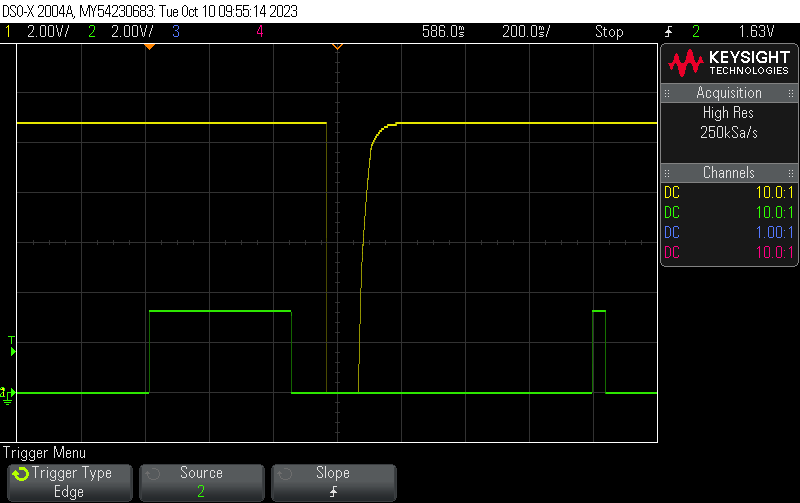

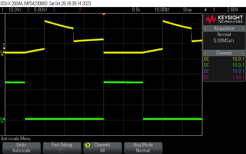

    I'm attaching example of Phase A driving, signal input on INHA (green color) and gate voltage on output on pin GHA.
    As mentioned earlier, pwm is not corresponding with voltage driving each of the high side of half-bridges. This problem is same for all high side mosfet gate signals like in my original post.

    What frequency is your PWM signal? As of right now that is the only thing I could potentially think is wrong.
    How are you measuring GHA? with respect to SHA? do you know what SHA with respect to GND looks like?

    I’m using calculated 100kHz switching frequency for used mosfets, but using 1kHz, 10kHz didn’t bring any difference.
    I’m measuring with respect to GND.

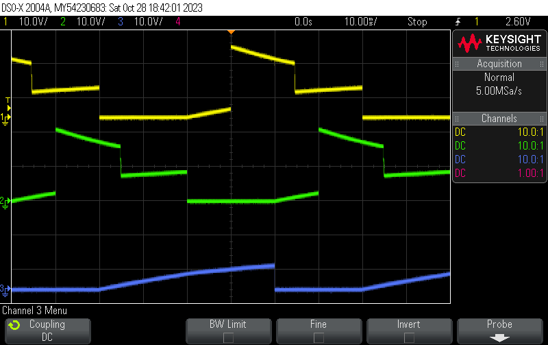

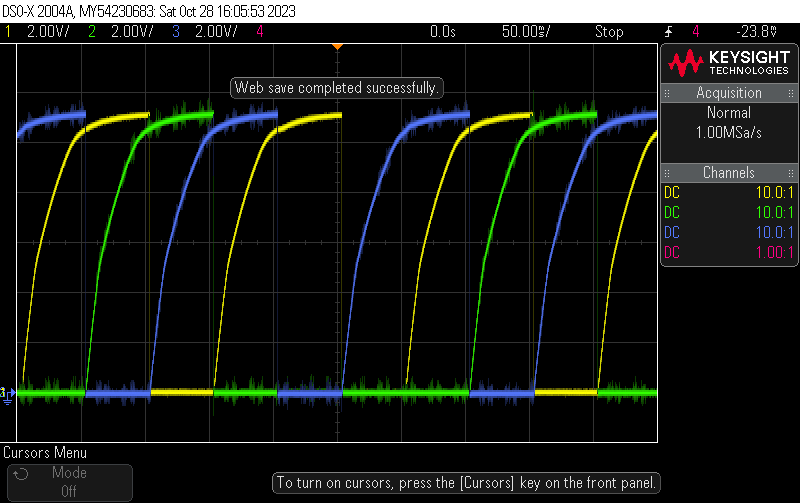

    I tested code with MCU sending PWM with right order  for used BLDC motor. I did not achieve correct work with DRV8300 on any of my design. I’ve tested now with inverting mode, it’s somehow better, but now my MOSFETs getting fried somehow, source to drain short.
    I’m attaching more waveforms. I pull-up mode pin to GVDD and double bootstrap capacitor value.
    Furthermore, I had 10 of the DRV ICs and 5 of them died unfortunately, only this one which has been put in place of previous one work like intended. Take note that the measurement weren’t made with load.
    Greetings

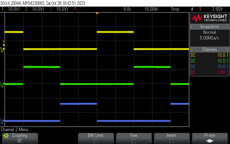

    All high side mosfets gate signal above
    All low side mosfets gate signal above
    First half-bridge mosfets gate signal above
    Second half-bridge mosfets gate signal above
    Differential signal of 1 and 2 phase - output
    Output of all 3 phases.
  • Hi Jakub,
    You should measure GHx and GLx with respect to SHx and SLx. If you are measureing GHx and GLx with respect to ground you could just be measuring SHx and SLx.
    For example if GHx is 12V and SHx is 12V, the differential voltage between GHx-SHx is 0V which means that the FET is not on and the output for GHx is off.

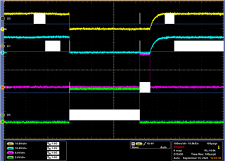

    I have measured now regarding to information provided. My bad for not correct measurement to gate signal. As what I can see right now the MOSFET gates are not driven at all. Vgs voltage stay at 0V despite PWM input signal or anything.

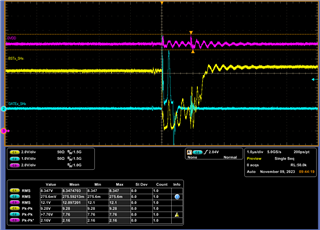

    Thank you for your patience. So finding out GHx is at 0V is leading us in the right direction to solve this issue. There could be a few reason why your high side gate is at 0V. Unfortunately there are no fault pins with the DRV8300 that would tell you whether there is a fault condition or not but there are still faults that can be encountered that would result in GHx being 0V, so to rule out under voltage faults proceed with the following.
    Can you provide your waveform for GVDD?
    Could you also provide BStx to SHx waveform? Note that if you do not have a differential probe and are using a single ended probe please measure BSTx to ground and SHx to ground.
    one last question, which side are you turning on first? High-side or low-side?

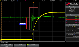

    I'm attaching measurements down below. If you need anything, please let me know.
    Measurements has been performed without any load (inductive or resistive).
    Greetings
    Jakub

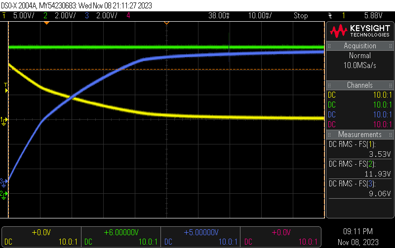

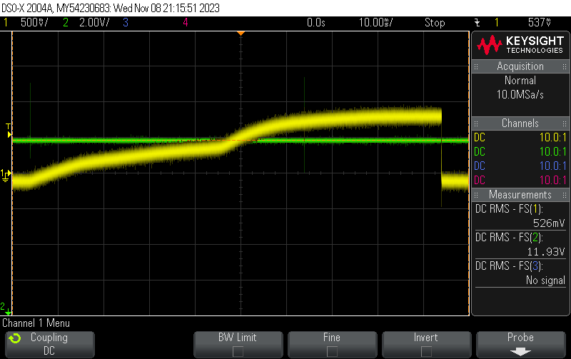

    Green - Input voltage
    Yellow - differential signal between BST1 and SH1
    Blue - Gate 1 with respect to ground

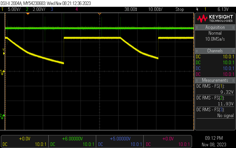

    Few fast spin of motor changing PWM and commutation sequence step

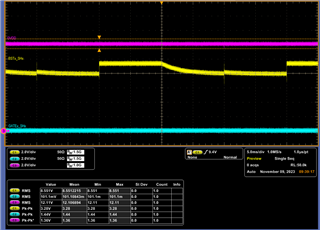

    One step of commutation

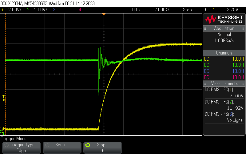

    Yellow - differential signal between SH1 and Gate1

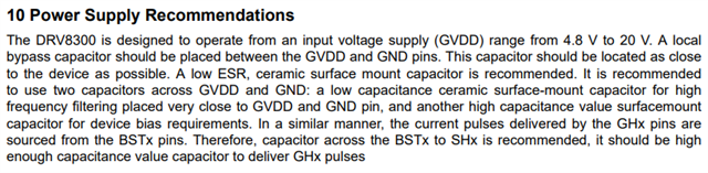

    From your waveforms I see possibly two issues. 1.There is quite a bit of noise on GVDD and 2. BTSx might not being reaching a high enough voltage to supply pulse to GHx.
    is it possible to implement the following into your schematic to potentially reduce that noise on GVDD
    and calculate the optimal BSTx to SHx capacitor using the following section in the datasheet : 9.2.2 Bootstrap Capacitor and GVDD Capacitor Selection

    As you can see in original post C5 capacitor, 1uF 0805, is implemented into the design. It is 3.3mm from side of the ic and path length is about 4-4.5mm. I’m attaching photo below.
    GVDD is 12V, which from I read is acceptable value for power supply. Power supply and oscilloscope are newly calibrated and did not produce any problem with a lot more demand testing and debugging. I’m using R&S HMP4040, Tektronix MSO5204B and Keysight DSOX2004A.
    Nevertheless, I’ll try different decoupling capacitor. I’ve tried calculated, based on datasheet, 100nF, doubled the value and I didn’t notice any difference in performance.

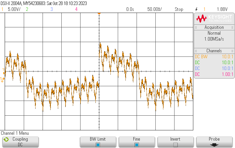

    As I mentioned previously, you could be encountering under voltage faults since we are only seeing issues on the high side. Have you tried operating at any other GVDD? anything high than 12V?
    Another thing to note is that you are seeing severe ringing on GVDD (from your waveform it looks like some spikes reach -20v if I am reading it correctly, this is well past the absolute maximum ratings) have you tried a larger capacitor on GVDD?
    I see in your schematic as well that there are no bulk capacitors present on PVDD?

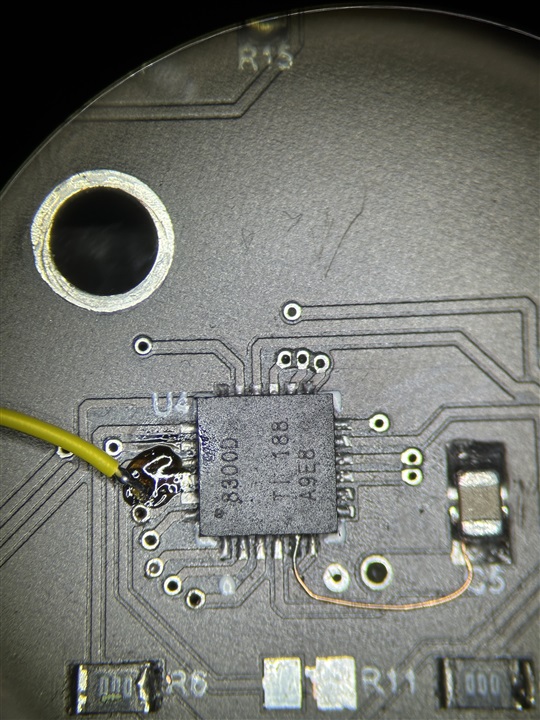

    In your layout picture there is quite a bit of flux going across a few pins on the IC, this could potentially short the pins.
    Ultimately there are a few things in your waveforms and layout that lead me to believe the ICs you are working with could have potentially been damaged and therefore not functioning properly. Even switching out the ICs probably wont solve your issue if there is something wrong with the layout. Is this the same layout you were using when you said the DRV8313 was working?

    I can't operate at any higher voltage than 12,5V. I don't see this much of ringing on the scope, minimum voltage drop on GVDD is no more than the level of 11V. Likewise, I can use bigger capacitor and check if there will be any different, but I don't think it will change anything.
    There is 47uF electrolytic capacitor on PVDD line, it isn't visible on this part of schematic.
    I use no clean flux, which has also been cleaned out using chemicals. I did a photo before cleaning it out, my bad.

    Sorry I may have misunderstood the waveforms, correct me if I am wrong but when I mentioned GVDD noise I was referring to this:
    as well as the noise on GHx to SHx, that seems severe enough to cause damage to the IC as well. Using the EVM in conjunction with the GUI might be beneficial in prototyping. Let me know how your further testing goes.

    About mentioned waveforms, you marked that value is roughly -20V, but looking at top of screenshot there is 2V per division and ground point is way below visible on screen (mark in left bottom corner). Voltage drop on the first one is from 12VDC to 7.8VDC, with better power supply it is max of 12V to 11.5V.
