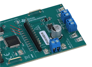

    I assume you are connecting to the single row heard on the EVM.  Did you also remove the resistors on the SPI lines between onboard MSP430 and the header?  Those need to be removed to avoid bus contention.  I highlight those resistors with red arrows.  Please check the schematic to remove the correct ones...arrows just pointing to row of resistors and not the exact ones to remove.
    Ryan
    No, I'm using a POLOLU carrier board with DRV8434S, using other microcontroller communication through SPI works. I'm in trouble with F28379D SPI.
    Waiting suggestions,
    Biagio
