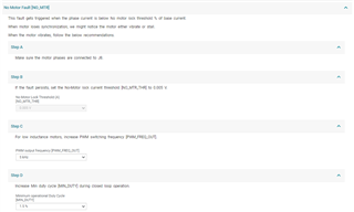

    If you still experiencing the NO_MTR fault after replacing the MCT8329 please try going though the steps outlined in the MCT8329 GUI:

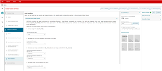

    To try and resolve the ABN_SPEED fault please try going though the steps outlined in the fault handling section of the GUI:
    Joshua
  • i tried going through the abn_speed fault steps yesterday without any luck ... anything in particular i need to try

    If you have followed the steps in the GUI to attempt to resolve the ABN_SPEED fault then please send me your register configuration and provide me the motor specifications for the motor you are using.

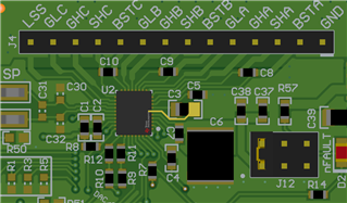

  • I would like to mention that I have encountered the same failure mode as described in the original post. My board looks strikingly similar to the images of the failed board shown earlier. I was operating with a 48V PVDD, while following the configuration outlined in the quick start guide, which is within the specified rating.
    Upon examining my board, I noticed that the short occurred between Pins 5 and 4 of the MCT8239 (or their pcb traces), which represents PVDD and GND respectively. The spacing between these pins is only 0.2mm, whereas the IPC9592 standard recommends a 0.58mm spacing for a 48V system. Given that this module is rated for 60V, I would appreciate some assistance in understanding how the EVM (and IC) spacing is deemed suitable for the rated voltage. I would like to use this dev board but don't want to order another one if this is going to happen again.

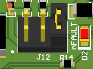

  • Hi Eric and Nathan,
    After aligning internally and preforming some testing it was determined that there is an error with the MCT8329 board which when operated above 48V will lead to the board damage that the both of you saw. The damage was caused by the voltage on the GCTRL pin exceeding its abs max values due to having VREG float which lead to the gate to drain capacitance of MOSFET Q7 pulling up the GCTRL pin past the abs max voltage when PVDD exceeded 48V.
    The solution for this issue is to either de-pop R56 or move the jumper J12 to the far right (closest to the nFault LED D2).
    We are working now to address this issue and will provide you both with a free board once this issue has been corrected on the boards.
    Joshua
