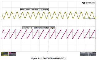

    The MCF8315A can output the estimated rotor angle using a DACOUT pin, see section 8.2.2.7 of the datasheet for more information on this. If you set a DACOUT pin to output the estimated rotor angle that pin will generate a waveform like the one labeled DACOUT2 in Figure 8-12:
    This waveform will rise from 0V to 3.3V as the rotor moves from 0 degrees to 360 degrees. Feeding this signal to an external microcontroller to interpret the angle from the DACOUT signal can then be used to determine the position of the motor. For position control, the MCU can then stop the motor at the desired position using the DRVOFF, BRAKE, or over I2C.
    Please keep in mind that the accuracy of this method will be limited due to propagation delay and resolution of the DACOUT signal.
