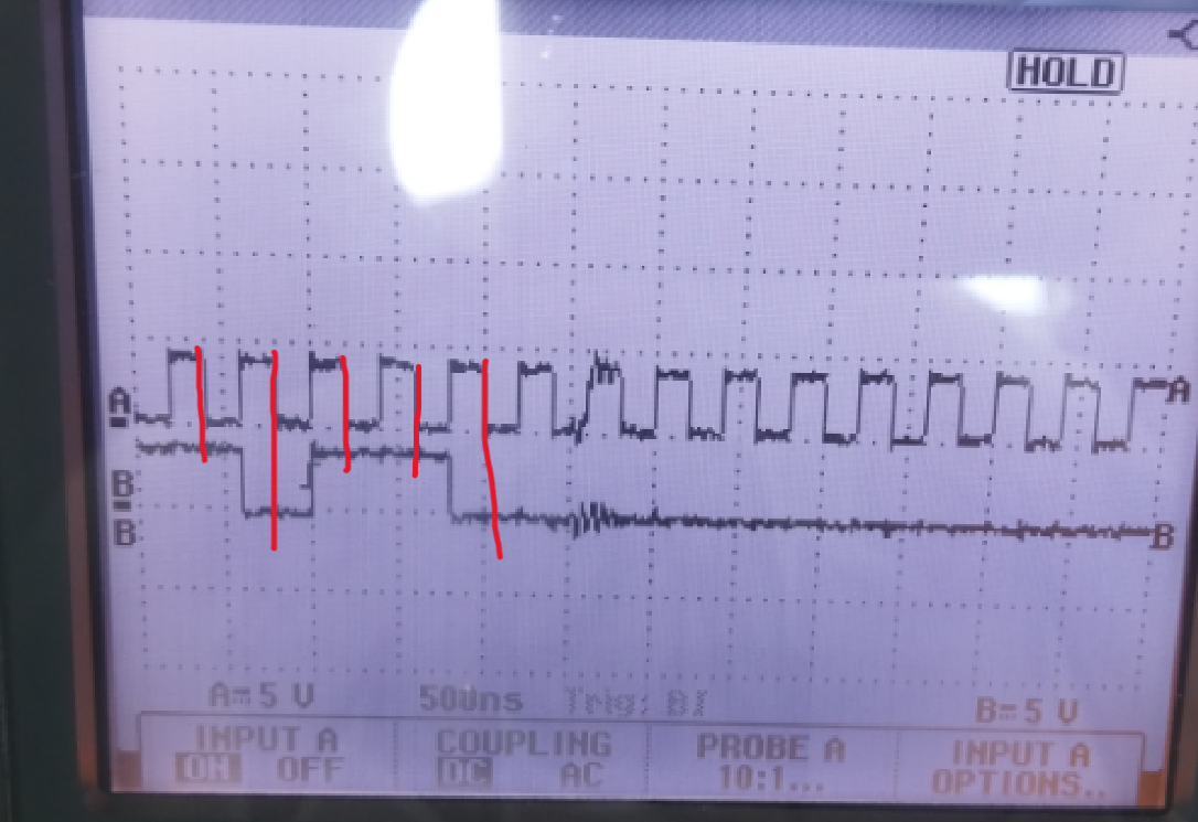

Hi Team,

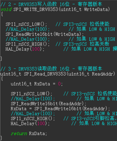

A customer tried to configure the DRV8353R to 1×PWM mode via SPI using the STM32 monolithic device, but the register parameter of the DRV8353R read back is always 0.

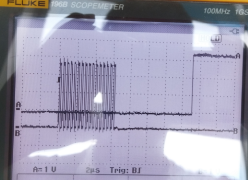

The board is powered up, the DVDD pin of the DRV8353R can output a 5V level properly indicating the chip should not be damaged. The SDO pin is pulled up to 3.3 V with a 2-kΩ resistor. The SPI is enabled and delayed on the Enable pin before writing data, but the correct data cannot be read.

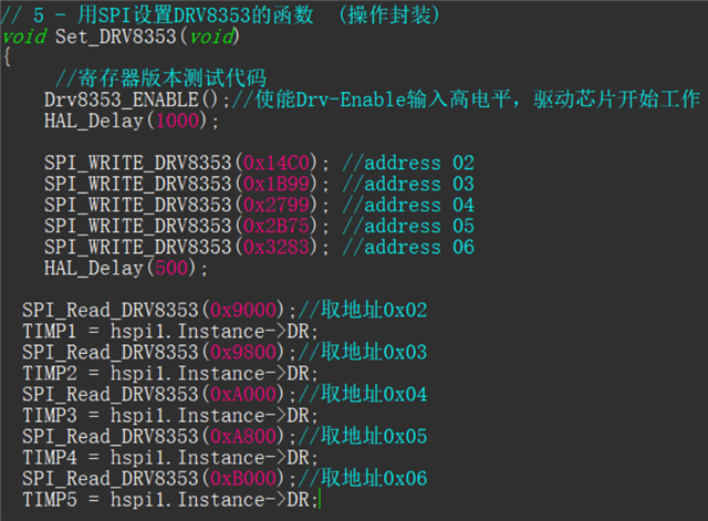

Here is the configuration code:
Could you please help check this case? Thanks.
