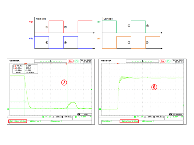

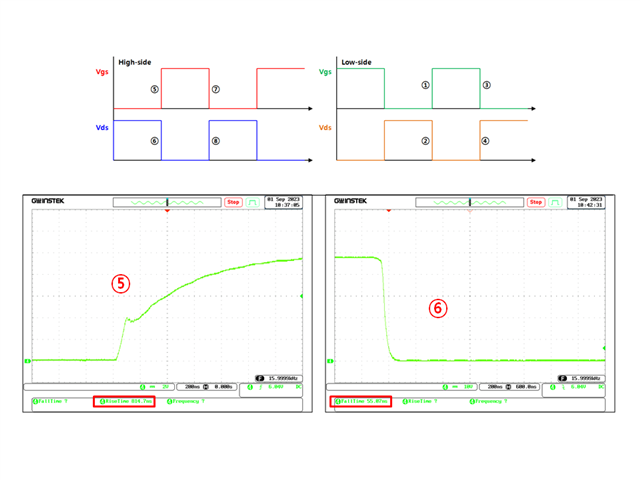

I recently constructed a 3-phase inverter circuit (motor driver) using the DRV8350H.
I would like to see how many questions and the design is correct of the DRV8350H.
1. It looks slow when I check the waveform of the VGS during the High-Side Turn on.
On the other case, High-Side Turn Off, Low-Side Turn ON/OFF looks fast.
And I can see slow Vgs(high side turn on) waveforms in the provided datasheet.
However, the rise time of Vds looks faster than slow Vgs.
Is this intended Vgs waveform? Is there a reason why only slow high-side vgs turn on?

3. I slowly raised IDRIVE and did a work to find the right value.
So it was confirmed that 300mA output (Iep) was optimal.
In 450mA, it was confirmed that the Vgs rose significantly when the MOSFET of the other side was turned on when the Vgs had to be turned off.
It was confirmed that this value rose closer to MOSFET's Vgs(th), and the IDRIVE setting value was not available.
How can I improve this and increase IDRIVE?
MOSFET specifications in use are Vds = 100V, Id = 230A, Cgd = 11.9nC, Vgs(th) = 2.8V
