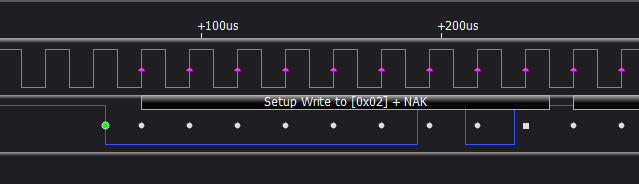

The lead controller is an FPGA and the waveform captured with the logic analyzer is as follows:

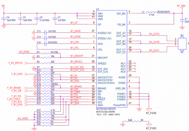

After the FPGA has sent the device address, no ACK signal has been received from the chip. The schematic is as follows:
The voltage tests for the external circuits are good, and the 0ohm resistors on pins 32 and 33 are without ACK no matter soldered or removed. Could you help check this case? Thanks.
