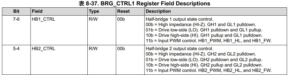

Hi Team,
Could you help share how to set HB1_CTRL and HB2_CTRL to Hi-Z at the same time? The customer sets HB1_CTRL and HB2_CTRL to 00 respectively, but only HB2_CTRL can be successfully set to Hi-Z, while HB1_CTRL presents the upper half-bridge pullup status:
Could you help check this case? Thanks.
