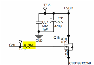

Are 33R to Gate still required, or it’s safe to use direct connection to GDRV (GHx, GLx)?
    The 33R resistors are not required and could connect directly to the gate.
    A 0 Ohm resistor is used on our EVM design for the DRV8718-Q1EVM.
