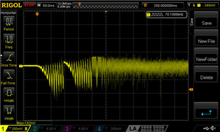

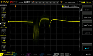

    If the startup fails, the RPM does not rise to the target value. The maximum RPM only goes up to about 200 Hz while the maximum RPM is about 800 Hz.
  • We believe the problem is that with the same set values, same IO conditions, and same board, the behavior is different and not reproducible to boot.
  • Currently I am not using speed feedback and am using the power control loop to limit input power. I think I have reduced the frequency of getting into a mode where I can only drive at about 200 Hz without reaching the maximum speed of 400-500 Hz, but it still occurs.
    I feel there is an order to the IO settings and startup process. I feel that there is something odd about the same parameters, board, and IO settings causing a difference in operating mode.

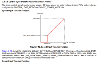

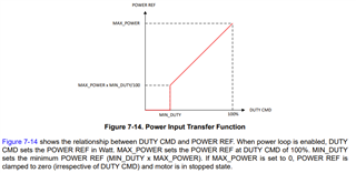

    You have enabled speed profile in forward - reverse mode. Can you once disable speed profile, verify and tell me.
    Also, please confirm what PWM frequency you are using. Please check for SPD_PWM_RANGE_SELECT bit and range should match.
    Thanks and Best Regards,
    Venkatadri S
  • Hi Shantaram san,
    Regarding speed profile, What do I need to correct? I don't see what the issue is.
    Regarding PWM input frequency, it is 400Hz. So, SPD_PWM_RANGE_SELECT is correct.
  • Hi Okamoto-san,
    This is just to check step by step to understand the issue. In the REF_PROFILES1 register bits 29:30 are 11, please make it 00 for duty controller mode.
    With this speed command should follow. Let us test this once.
    Venkatadri S

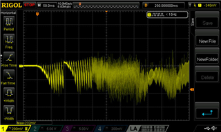

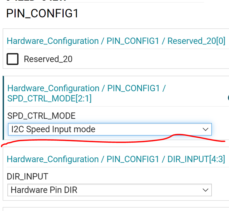

  • I took your advice and set REF_PROFILES1 register bits 29:30 to 00b and ran it in Duty control mode. As before, at times the motor rotates up to 500 Hz, but at other times it only rotates up to about 200 Hz. Here are the parameters I used.

  • I also tested with linear control profiles with similar results.
  • Hi Okamoto-san,
    Thanks for checking the configuration. I will test it out with your configuration on the EVM. I will reply by end of Friday this week
    I should test this with 400 Hz PWM as speed command  right?
    Did you try this with I2C based speed command ?
    Venkatadri S
  • Hi Shantaram san,
    PWM operates between 44% and 76% at 400 Hz.
    Not yet tested on I2C.
    My impression is that the feedback control is not working as commanded even if the command value is given appropriately. In the forward reverse control mode, duty cycle control mode, and linear control mode, at times the feedback control operates as commanded (500 Hz), and at other times it does not operate as commanded and does not reach the maximum speed at about 200 Hz. It is understood that whether it works well or not is determined at startup. Is there some kind of tying or order to the initialization process, etc.?
    Best Regards.
  • Hi Shantaram san,
    Do not test with no load, because it is impossible to judge whether the phenomenon is OK or NG unless the motor is under load.
    Tomofumi Okamoto

  • This is DC bus voltage with no load condition around startup timing. Regarding with load, I will update the data later.
    The dip voltage is appeared such as 600mV.

    Our system has independent left and right motors and MCT8329A is used for both left and right motors. Will your IC still work in this case?
    Also, when OL_ILIMIT is changed from 1.4V to 1.0V, the motor does not start in some cases. The motor turns more reliably at 1.4V for this parameter, but would it be better to lower the value?
    We observed the voltage waveform at startup, but the voltage waveform did not appear to be different between when FB control is established and when it is not. From what perspective should I acquire the waveforms?
    <FB Control OK Pattern>
    <FB Control NG Pattern>

  • The two motors are operated independently by two MCT8329As. Naturally, the PWMs are also independent of each other.
    The waveform here was magnified by AC coupling to acquire the waveform. Because the ripple of the DC bus voltage is extremely small, the ripple voltage is too small to acquire magnitude with DC coupling. Waveform acquisition is possible, but the ripple cannot be observed. The voltage of the DC bus is stable because OS-CON with good frequency response is implemented on the DC bus. Do you need waveforms with DC coupling?
    From the above two waveforms, we can observe that the voltage after Double Align oscillates significantly because the inverter is driven at the optimum drive frequency and high current. On the other hand, the NG waveform is driven at a non-optimal frequency and low current, so the voltage oscillation after Double Align is small.
  • Hi Okamoto-san,
    Have we done I2C based test here? To do that you can got PIN_CONFIG1 and make change as shown below.
    Also, make changes to following configuration.
    1. CLOSED_LOOP2 -> BRAKE_DUTY_THRESHOLD is configured as Immediate. Please change this to 25% or even lesser may be 15% if motor don't lose sync
    2. MOTOR_STARTUP2 -> MIN_DUTY is 25% . With this whatever duty we apply below 25 controller uses 25% to drive. Do you want it like this? Or you can reduce it
    3. MOTOR_STARTUP1 -> ALIGN_TIME is 100ms in your setting. This time may be very less, please check if aligning at stable point before open loop starts, otherwise motor may lose sync.
    Apart from this, please enable all the faults and configure them in Latch mode.
    LOCK_ILIMIT_MODE Make is Latched (00)
    MTR_LCK_MODE Make is latched (00)
    Venkatadri S

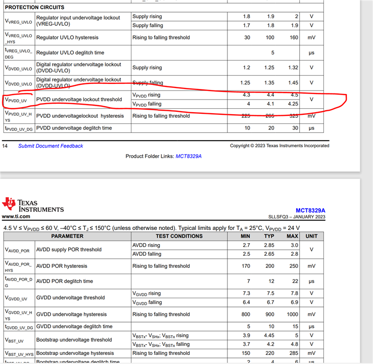

    What is the voltage of PVDD at which the power-on reset of the MCT8329A is applied?
    Tomofumi Okamoto
  • Hi Okamoto-san,
    Please refer to the Under Voltage Lock out specification, PVDD, AVDD range in the table below
    In the tuning file   CBC_LIMIT, ALIGN_LIMIT are same level and LOCK_ILMIT in fault config1 is 00. You need to set the limit to a level which is above application expected value with some buffer to avoid unintended false triggers.
    Please apply required range and test it with I2C mode once. Please let me know your observation.
