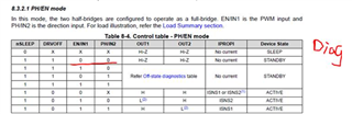

My customer want to confirm that what is the status of DIAG pin when nsleep H/DRVOFF H/EN L/PH L? It is High, Low or HiZ?
Lanxi

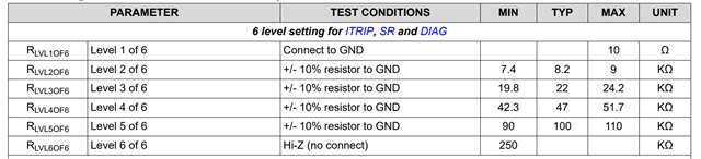

Hi Lanxi,
The DIAG pin is an input and it is a 6-level setting depending on the resistor attached to it:
This sets the latch/retry and the diagnostics behavior for the driver and are latched at power up. What is the need to know this and what is the application.
