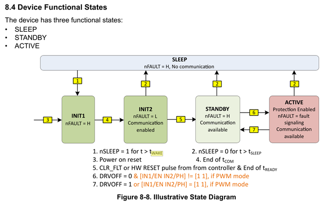

I have an issue where the nFault of the driver is constantly triggered, even after performing a reset pulse on the nSleep IO.

  • Hey Avi,
    Have you confirmed that your nSLEEP reset pulse is ~30us?
    Jacob
  • Thank you for your answer!
    Yes we have verified that the pulse is ~30us, you can see that in the provided image. the "HW Variant Wave-up Transient" is exactly what we've been following with no success. It does reset the nFAULT because it's rising up, but it drops again right after (after ~300us).

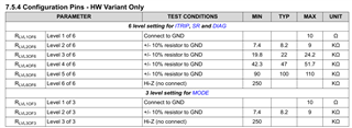

    I see your pull up resistors for nFAULT and DRVOFF say "103", is that 103Ω or 10^3 = 1kΩ?  100Ω might be too strong of a pull-up resistor for nFAULT.  I think it needs to be at least 1kΩ.  InFAULT_PD (Sink current to GND on nFAULT pin when asserted low) is >5mA, so for 3.3V R=V/I --> 3.3V/5mA = >660Ω.  Recommend using 10kΩ value
    Just my notes while looking through schematics
    • MODE pin GND --> Device in PH/EN mode
    • DRVOFF 103Ω(?) to GND --> whether this is 1k or 103Ω, this does not fall in any of the RLVLxOF6.   Recommend changing this to match one of these levels:
      • Resistor is not needed for short to GND
    • ITRIP 22kΩ to GND --> Rlvl3of6 -->1.98 V ITRIP.
    • DIAG 8.2k to GND --> RLVL2OF6 ---> in PH/EN mode, Off-state diagnostics enabled, fault reaction is latched fault.
    • SR to GND --> 1.6V/us slew rate
    Try changing that DRVOFF resistor and see if that solves it, I'm not sure why that would cause nFAULT to stay low.
    Given that your off-state diagnostics are enabled, I wonder if those diagnostics are causing this fault indication.  You could try connecting DIAG direct to GND to disable off-state diagnostics to see if that makes the nFAULT issue go away.

  • Hello and thank you for your response!
    103 is 10Kohm, it's an SMD resistor code.
    I already tried 2 things today that did not work:
    1. Wired the DRVOFF straight to the GND. I also noticed that there should not be a resistor there, unfortunately that didn't do the trick.
    2. Set the R_MODE to >250Kohm to enable the PWM mode, unfortunately I got the same output on nFAULT.

  • Hi Avi,
    It is likely that the device needs a clear fault command after the nFAULT is triggered. This is a common occurrence during the power on reset (POR) of the device.
    David
