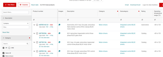

   we are looking for plug and play option for BLDC sensorless driver. I explore on TI product and found below options with high power rating , but this requires GUI to operated motor.
Is there  any IC or reference evaluation kit where we can connect three phase wire of motor and rotate without making any connection with laptop or GUI. we are looking for some integrated option like driver chip with integrated MOSFET without microcontroller.
Required power rating is 60V and 5 to 10A

  • Hi Sayali,
    For devices with integrated control and integrated MOSFETs that can support 40-45V max we have our MCx8316 devices, MCx8315 devices, and the DRV10987. The MCx8316 can support up to 40V - 8A peak the MCx8315 can support 40V - 4A peak, and the DRV10987 can support 45V - 3.5A peak.
