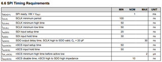

Hi experts,
How do the customers set the timing by referring SPI Timing Requirements. Is there something like timing chart?
Youhei MIYAOKA
Hi experts,
Youhei MIYAOKA
Hey Youhei,
It will be similar to this chart from this post
This is standard SPI timing naming for TI devices, also see this TI Precision Labs video SPI communications timing
Jacob
