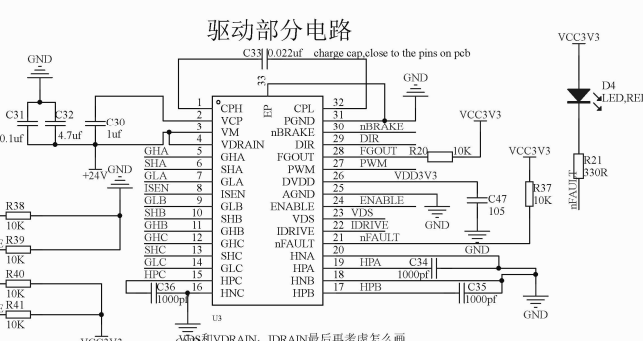

Customer team had difficulty starting the motor when using DRV8306. When the motor is unloaded, it can be started normally most of time. However, when the motor is loaded, even if the loaded is small, there is a problem of starting difficulty. At this time, if giving the motor a torque, then the motor can be started.

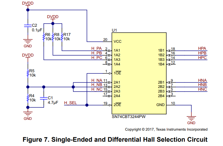

    There's one more question:
    On TI's evaluation board, the HPx is connected to the DVDD by pull-up resistor, and the HNx is connected to the DVDD/2 by divider resistor.(single-ended Halls signals)
    Customer connected the HPx to the DVDD by pull-up resistor too, but they connected the HNx directly to GND.
    Is there any problem with this connection? Would it be the possible cause that due to this connection the motor can not start with load?

  • Hi Cherry,
    Connecting the HNx pins to GND should not lead to an issue with being able to drive a motor, especially if the motor can spin without load with no issues.
    Usually being able to spin without load and then seeing issues with startup with a load, but spinning with the load is operating fine, indicates that there is not enough current available to the motor to overcome the required starting torque.
    Joshua
