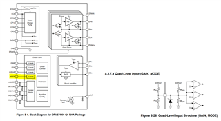

I understood that DRV8714-Q1 has feature for current limiting through external shunt resistor.
Datasheet specified 4 levels of internal amp gain mode when using HW variant.
Could you check if my understanding for gain mode setting is correct?
For resistor connected to MODE pin,
Quad-level 1: gain 10V/V (typ), direct to GND
Quad-level 2: gain 20V/V (typ), 47k Ohm to GND
Quad-level 3: gain 40V/V (typ), Hi-Z(float?) or GND through over 500k Ohm
Quad-level 4: gain 80V/V (typ), direct connection to DVDD
