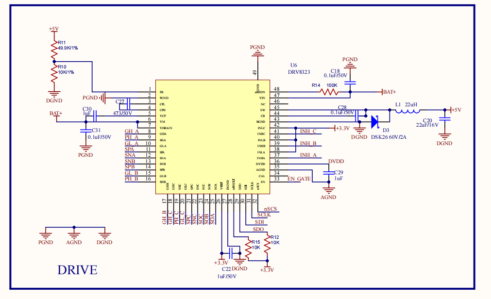

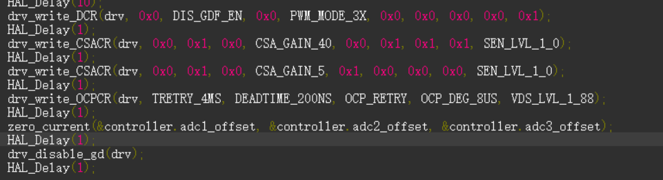

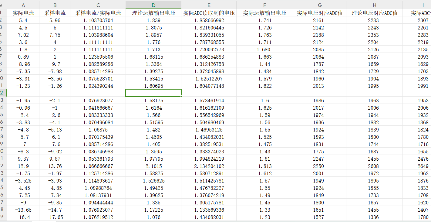

When using the operational amplifiers of the 8302 and 8323 drive chips, the sampling current value is higher than the actual current value, resulting in a lower actual motor force. This problem improves by reducing the magnification factor and increasing the sampling resistance, but does not solve the problem at all.
The customer would like to know the root cause of this issue, would it due to the magnification of the operational amplifiers of the 8323 and 8302 inaccurate? Thanks.
