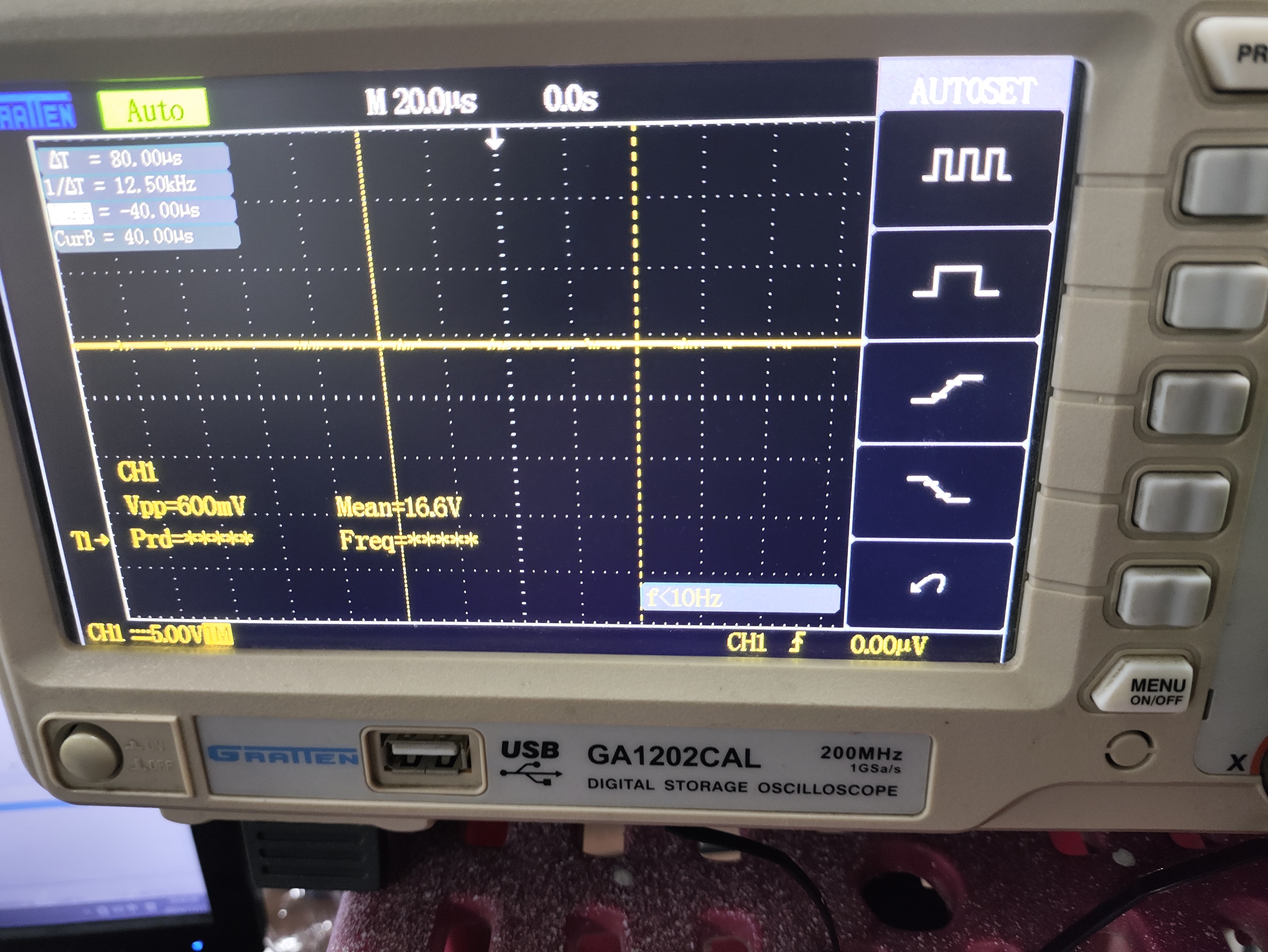

  • Hi Joshua,
    The figures of the 3 GH signals when a non-working chip begins to power on and not give a signal are as follows:
    GL signals are as follows:
    The voltage supplied is 16V, and the chip gets hot as soon as it is applied, but it does not report any error. When the PWM signal is given, the GH GL signal is still as shown in the figure above, but a fault is reported, regardless of which low input is pulled high.
    Error only occurs when power is applied and signal is not applied, the voltage value for GHC is 21 V, the voltage value for GLC is 200 mV, and the voltage values for a and B are 16 V.
    When the low inputs of a and B are pulled high and no error is reported, the GH outputs are as follows:
    However, when the C low input is pulled high, the output signal of the GHC is as follows:
    Thanks and regards,
    Cherry

  • Hi Joshua,
    Just give some updates for more tests:
    In 3xPWM mode, the PWM frequency is 20 kHz and the error in sending the PWM wave still occurs. The following are the fault and enable signals:
    The INH signal and fault signals are as follows:
    The waveforms and fault signals for the GHC are as follows:
    They have also tested the 1KHzPWM waveform. The following figure shows the fault signal and GHB output waveforms:
    The following figure shows the 100-Hz fault signal and GHB output waveform:
    The following figure shows the GHB signal and INHB input signal waveforms at 5 KHz:
    The following figure shows the GLB signal and INLB input signal waveforms at 5 KHz:
    The current resistance between GHX and SHX is 470 kΩ and GLX to ground is 149 kΩ.
    Thanks and regards,
    Cherry

  • Hi Cherry,
    I apologize for the long delay in support for this issue.
    If there is still interest in resolving the matter, I have the comments below:
    If this occurs only on the specific IC and the EVM works normally when replaced with another DRV8323, it appears the device was most likely internally damaged due to a violation of abs max. It was said that there is no shorting condition observed, but can you provide the resistance measurements of all Gates (GHx/GLx), VM, VDRAIN, and VCP on the working device, as well as on the unit experiencing issues?
    Has this issue occurred on any other evaluation boards used, or is this a single instance?
    And lastly, can we also confirm if the IC/board behaved correctly at an point in time before the heating issue started?
