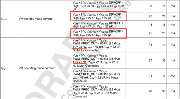

My customer has below questions regarding MCF8315, would you pls kindly share your response?
1. For the VM standby mode current, are these two circled ones duplicate?
For the operating mode current, are the two underline ones for 25C and the other two full temp range?
2. Do we have recommendation for DACOUT1 and DACOUT2 configuration? Which variables we use to monitor?

  • Hi Scarlett,
    1. For this question we will get back to you. That is an error in the data sheet.
