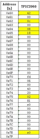

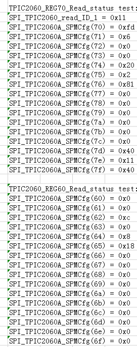

  • Hi Norikazu,
    The figure above shows the values written to the relevant registers at initialization where REG64 writes 0x08, which is BIT3 set to 1.
    When set, all registers are read as follows:
    Where reg74 sometimes reads 41 (0100 0001) and sometimes 01. Monitor event flag Bit6 pointing to REG7D(0X40) is XRSTIN_DET(XRSTIN event flag 1=detect low event in XRSTIN pin) this pin is pulled high (held in communication) by the DSP GPIO during test, followed by reading and writing of the associated registers.

  • REG74 Bit 6 is reserved bit and nothing is assigned. This bit should not be changed. REG7D bit6 is set when XRSTIN is pulled down. (Reset input). If the bit is 1, it means DSP resets TPIC2060A.
    I don't have answer to your questions about DSP program and interrupt routine because I don't have information about DSP.  For question 3), TPIC2060AS does not count the FG pulses to calculate the speed, TPIC2060AS detects filtered FG signal to determine the timing for driving next phase. DSP need to calculate the speed and change the VSPM DAC value to adjust the speed.
    It looks register value is not read correctly or unintentional XRSTIN happens.
    The register status write of REG74 to 0x20, which starts the status of the STAUS_on_VFCS function. The power-up register read is also 0x20.
    Customer has corrected it.
    If the DAC value is larger, the spindle speed is faster, and the signal period of FG is shorter, right? However, when the DAC value is written to 0x324, the measured FG period under the oscilloscope is 694us and the signal period is stable and long. Reading the FG register is changed very quickly for a fixed sample period and has no pattern.
    Register 7E Version is always 0x11 and the data written to it can be read correctly.
    Unintentional XRSTIN: Register 7D is 0x00 state, the possibility of this case is small.
    With the same program, a read of REG0X7D is 0x40, reloading the program and then running it, it will read as 0x00.
