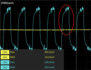

I would like to inquire about the current waveform that occurs when driving at low and high speeds under the stepping motor driving conditions of the DRV8889-Q1EVM.
Drive input voltage : 12[V] , current limit of stepping motor : 500[mA] When driven, the coil outputs a waveform as shown below. This is a comparison of the waveform of the applied current according to speed.
1.3500rpm
 2.3900rpm
3.5400rpm

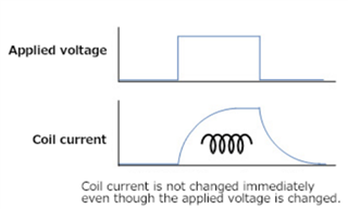

I understand current waveform of 3500~3900[rpm]. This is because as the speed increases, the waveform of the current applied to the coil changes due to the inductance of the windings.
www.pulsemotor.com/.../stepping-motor-drive-IC_04.html

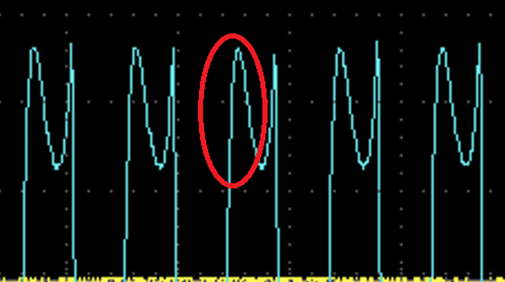

However, at 5400[rpm], the current waveform shows different characteristics from 3500~3900[rpm]. The front part of the applied electric current should be attenuated, rather it shows a size close to the limiting current.
As the speed increases, the inductance and back electromotive voltage increase, so the size of the current applied to the stepping motor should decrease, rather it shows the opposite tendency.
Could you please explain the reason for this phenomenon?

    Thank you for your post and thanks for sharing the current waveforms. Based on the waveforms it appears you are using full-step mode. Like you mentioned, at high speeds the current will not rise fast enough to reach ITRIP level set by VREF and result in distortion not only due to inductance of the coils but also the back EMF. Back EMF is the primary contributor. The back EMF is a sinusoidal voltage opposing the voltage applied across the coils by the driver. Depending on the load on the stepper motor there is a phase difference between the back EMF and the coil current, see page-36 of the datasheet. This phase difference causes ups and downs in the coil current causing the waveform captured with 5400 RPM. (is this accurate calculation for RPM? such high speeds are unusual in stepper applications. Steppers are not designed for high RPM\. Just a note.). If you load the motor you can notice the waveform would change and when you stall the motor the waveform will become normal because back EMF turns 0.
    The DRV8889-Q1 does not have a boost voltage for VM. The charge pump boost is used for generating the voltage necessary for driving the HS output N-FET. It must not (cannot) be disabled while the driver is in operation. The charge pump is disabled when the device is in sleep mode.
    To have cleaner current waveform at higher speeds the VM supply must be increased from 12 V to a higher value enough to overcome the back EMF voltage. Having a distorted waveform is a non issue as long as the motor does not skip steps. It is expected behavior. If you're using the stall detection feature of the device it may be impacted with distorted current waveform and likely will not work as intended.

    1-2 By load I meant the mechanical load on the motor. For a mechanically unladed free running motor (nothing connected to its output shaft) the phase difference between back EMF and the drive current waveform will be close to 90 degrees. When the motor is fully loaded (about to stall under the mechanicall load) the phase angle will be close to 0 degrees. The back EMF voltage opposes the applied voltage and may result in a waveform like you had (shown below). This pattern will change when the motor is mechanically loaded because the phase angle of the back EMF changes. This is what I meant. If you increase the VM supply voltage high enough this distortion will disappear. This is how a stepper drive is expected to behave. The higher the speed of the motor the higher the back EMF amplitude. This causes the current distortion is VM is not sufficient to overcome the back EMF and provide enough voltage across the coil to pump in the target full scale current IFS.
    Second inquiry:
    I assume you were referring to a software analysis using mathematical model. How did your model get proper back EMF modeling? Did you get the back EMF constant of the motor from the vendor. This parameter is not commonly available. Typically you may have to model this yourself to perform accurate simulation. You asked "What causes the current waveforms in FEM analysis and experiment to be different?". My guess is you used only the L/R time constant in modelling and did not account for back EMF sinewave generated opposing the applied motor voltage. Like I mentioned in the first post the back EMF opposes the applied voltage across the coil. It is 0 V when the motor is standstill and increases proportional to the motor speed.

    I referred to an undistorted waveform as a cleaner waveform. You are correct, in your application it would mean like the waveform at 3500 RPM.
