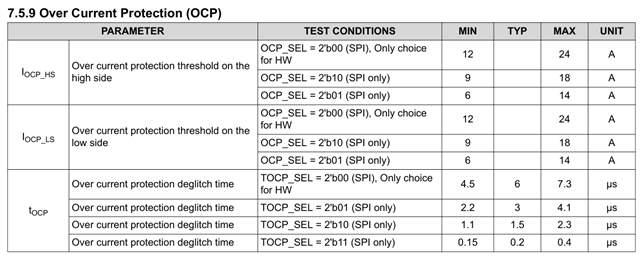

What is the maximum clamping energy (Joules) that the device can withstand when switching inductive loads.?
Hey Vishnu,
Our devices typically have maximum voltage and current that the device can withstand. If the voltage goes beyond VM_MAX (40V) then it can damage the device, or if the current exceeds the OCP current+time it can damage the device. As far as I know we don't have a joule spec.
