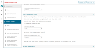

  • I believe this gate driver fault is closely related to the Loss of SYNC and Motor Lock errors. Even if I disable these errors, Loss of SYNC and Motor Lock are still detected, probably because nFAULT is temporarily lowered. I will check this experimentally at a later date, but is it possible to raise the detection threshold for these errors?
  • Hi Okamoto-san,
    To increase the detection threshold for Loss of SYNC, you can increase the number of sync loss detections are required before triggering the fault by changing the value of LOSS_SYNC_TIMES (bits 21-23) in register FAULT_CONFIG2. In FAULT_CONFIG2 you can also disable the Loss of SYNC fault by setting bit 29 (LOSS_OF_SYNC_EN) to 0.
    The detection threshold of Motor Lock cannot be changed but the action taken when the fault is detected can be changed by changing the value of bits 3-6 (MTR_LCK_MODE). values 9h-Fh will disable Motor Lock detection.
    Joshua
  • Hi Joshua,
    Thank you for your reply.
    What I have found in my recent testing is that the nfault pin drops when loss of sync and Motor lock occur continuously. At this time, it stops without any specific error and latches the output stop status. Is this behavior in accordance with the specifications? I do not see this behavior on the datasheet.
    We try to start and stop smoothly so that loss of sync and motor lock do not occur, but loss of sync and motor lock are unavoidable depending on the usage and speed command. Can you please advise me what settings are desirable? Is it simply a matter of setting the threshold in a direction that makes it less likely to occur?
  • Hi Okamoto-san,
    If a loss of sync error occurs then the Motor lock fault will also occur, this is because Motor Lock will be raised if either of the following faults occur: Abnormal Speed, Loss of Sync, or No Motor.
    Based on the fault settings in the register config you provided, the motor lock (this includes Loss of Sync) is set to retry after t_CLK. This settings is what is causing the nfault pin to drop continuously, if you set it to Latch the device should stop after the first instance of a Loss of Sync fault is detected.
    For the LOSS_OF_SYNC errors, we have a guide for debugging this issue in the MCT8329A_GUI on dev.ti.com. To get to the guide, click on the gear icon -> Essential Controls -> fault handling -> Loss of Sync:
    When the motor losses sync the motor will either vibrate or stall. Since it seems like the motor is stalling decreasing open loop acceleration A1 [OL_ACC_A1] and open loop acceleration A2 [OL_ACC_A2] may help to resolve the motor stall issues. If the motor vibrates you can try to increase align time [ALIGN_TIME] and decrease the closed loop acceleration [CL_ACC].
    Can you please try and follow this guide, if you have not already, to eliminate the Loss of Sync fault?
    Joshua
  • Your advice is very helpful. Thank you very much.
    I have been able to improve the situation a lot by lowering ACC, etc. and slowing down acceleration and deceleration, but loss of sync and motor lock occur quite often at the forward and backward changeover. If you know what parameters might be effective in this situation, please advise. Attached is a list of parameters.
