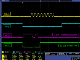

SCLK minimum period = 0.1 s
SPI speed: 537.109 Kbits/s ⇒ Time to transfer 1 bit = 1.86 s (verified value on the scope)

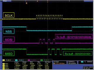

1) Write OCP register
Default value - 00101101101
Value to be written - 00100100000
Value received in Rx buffer as expected (value before modification)
2) Read OCP register AFTER writing the modified value to it
Value not being written to the register - there are no SPI errors but not able to modify the register
When I do a read, the default value is still being returned.

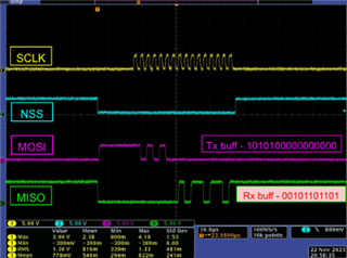

3) Read GATE DRIVER HS register (to check is SPI register bits are locked)
MSB of data bits - 011 (unlocked SPI registers)
CODE
