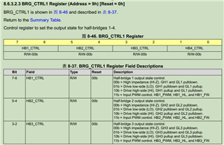

The customer performs an over current diagnostic test with drv8718-Q1 operating normally.

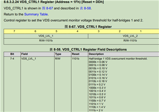

The BRG_CTRLx channel control register is set to control channel output. The VDS_CTRLx, VDS overcurrent detection registers are set. Where the VDS register value is set to 1V.
However, when overcurrent is detected, the device does not feedback a VDS error. Instead, a PVDD error is being reported.

    Can they check PVDD supply voltage?  It is possible to get a PVDD error if the supply falls under a heavy load condition like a short condition.  If the power supply is unable to supply the current, the PVDD supply will collapse and cause an error.

  • Link,
    The power supply just needs to be capable of providing the current that occurs during a short.
    Please see the following section in the datasheet that discusses which registers need to be configured.
    8.3.8.8 MOSFET VDS Overcurrent Protection (VDS_OCP)
    Yes, the outputs must be disabled so internal current sources used for offline diagnostics can be used.
