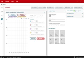

Tried to use Spin and Evaluate option on the GUI but the graph remained blank during Play, During Record it generated .cvs file with only col. A TIME in ms filled, nothing gets filled in channel 1 or channel 2..
