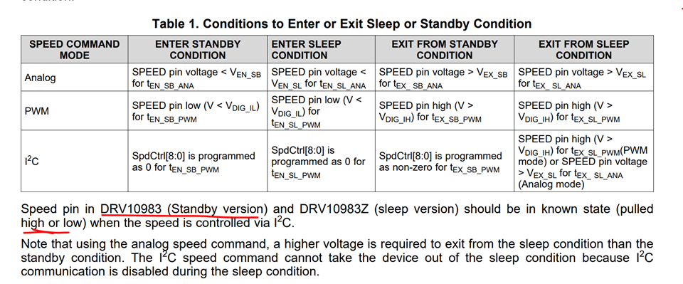

    For the SPEED, I understand can be programmed to the EEPROM. In this case, what should do for the PIN?
    For DIR, for low, can connect to GND? For high, can pull with a resistor to VCC?
  • Hi Mohamed,
    Speed pin put it in know state High. We can refer to table and description in the data sheet
    Yes DIR pin you can connect to ground as ir or use a pull-down resistor with strong pull down so that noise does not affect the DIR pin.
