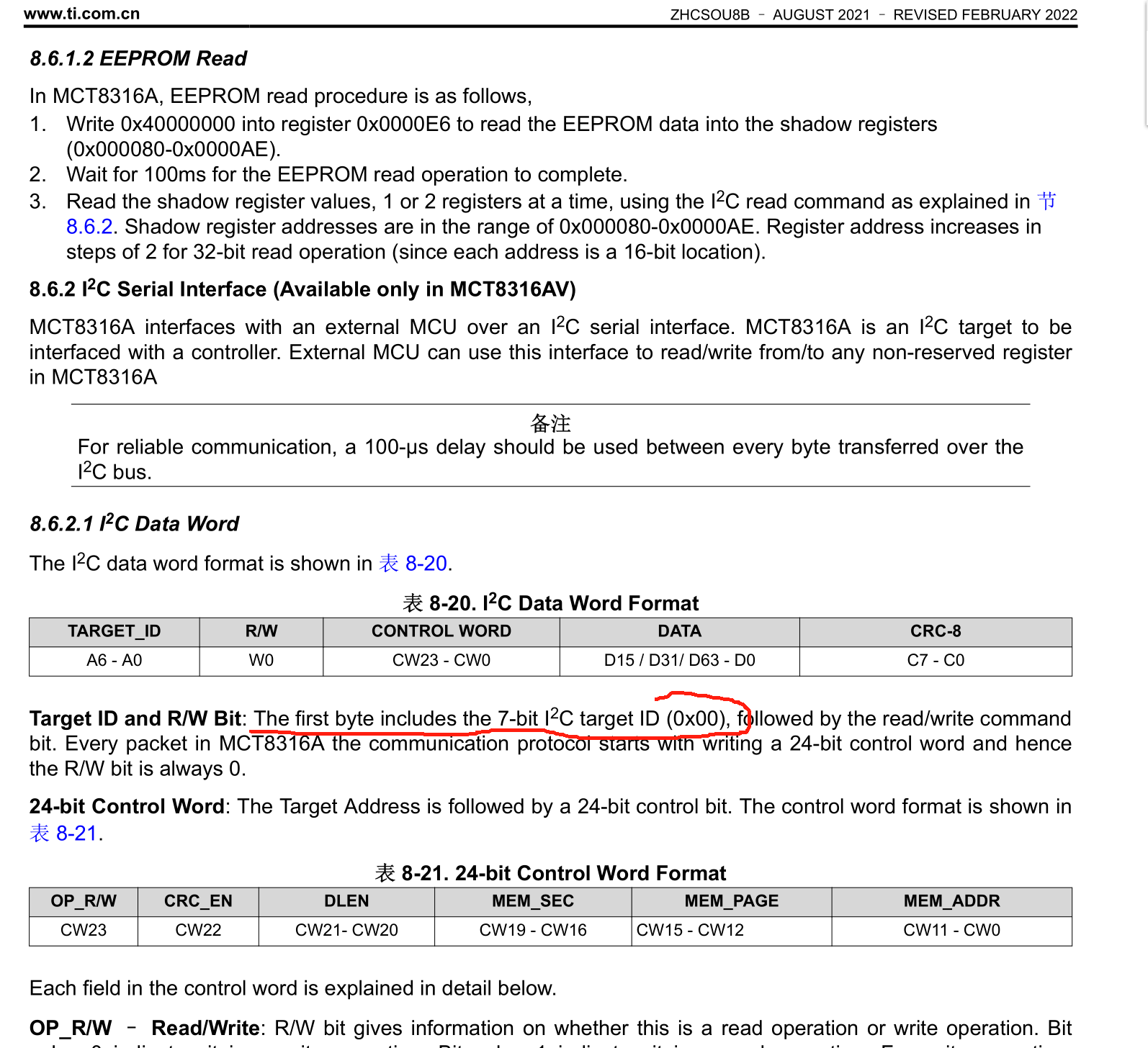

1) According to the MCT8316A manual, Target ID is 0x00, that is, MCT8316A address is 0x00 for I2C communication, correct?
2) Can the Target ID of MCT8316A only be set to 0x00? Is it possible to change it to a different value? If so, could you help share how to change it?
Could you help look into the above 2 issues? Thanks.
