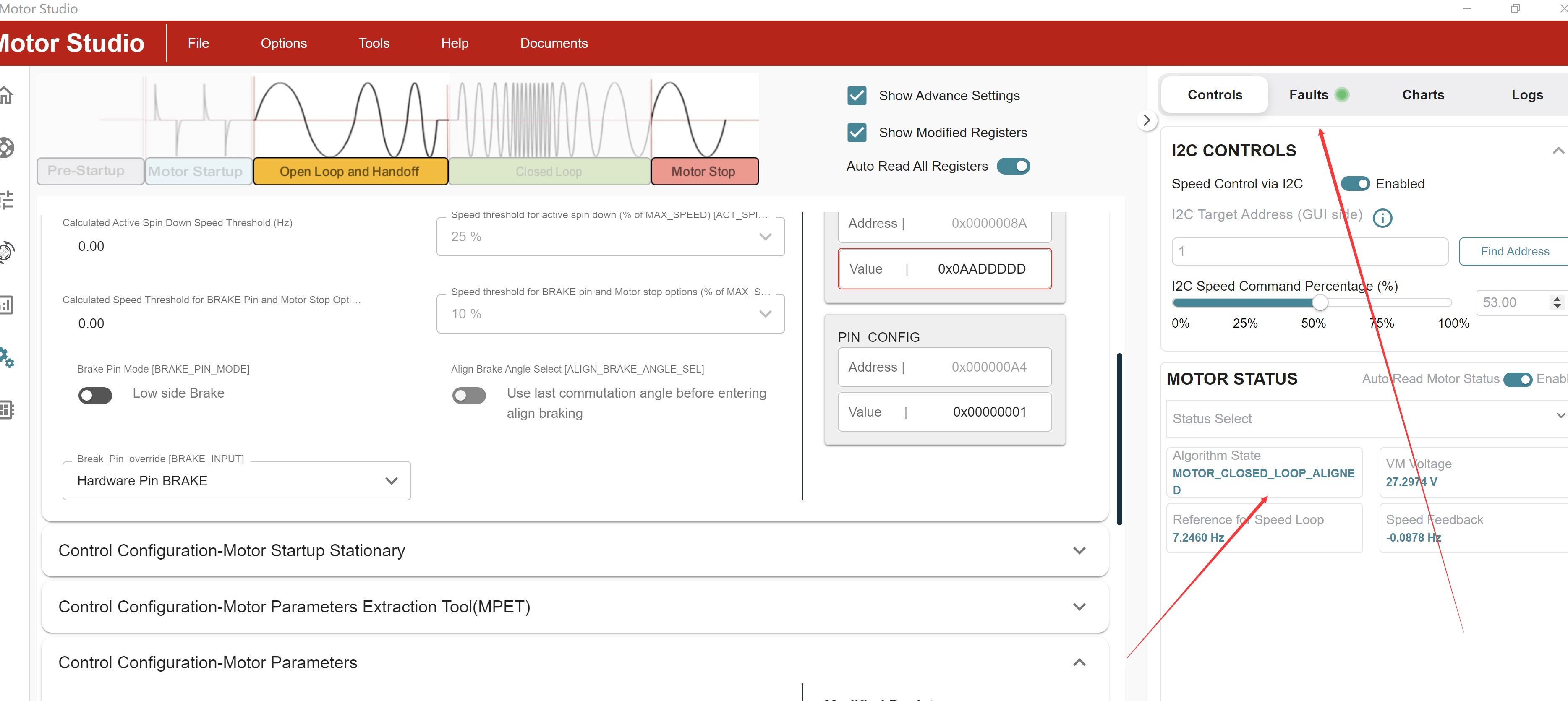

Hi Team,
TI EVM are being used, and it went down after a period of operation and no any errors were reported.
Could you help check this case? Thanks.
Cherry
  • Hi Cherry,
    I see that Auto Read Motor Status is enabled. The MCF8316A has a known I2C communication issue listed as Errata #8 in our Production device information FAQ. If I2C communication is made with the MCF8316A while the motor is spinning the device will not longer respond to I2C communication and will need to be power cycled to recover. To avoid this Errata we recommend not sending any I2C read or writes to the MCF8316A while it is operating the motor.
