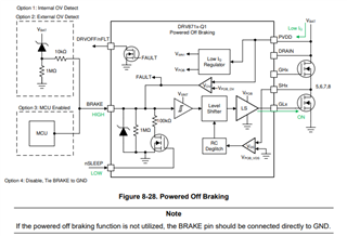

DRV8714-Q1: Brake pin reference GND inside the IC
Part Number: DRV8714-Q1
Hello Team
I would like to know the GND that is the reference for the brake pin in the IC.
DRV8714S-Q1 RHA has GND and two PGND.
These are connected to the same potential outside the IC, but are separated inside the IC.
Which GND is referenced by the brake pin inside the IC, PGND or GND?
If you look at the circuit block below, it appears to be used in the Gate Driver block and the reference is taken from PGND.
