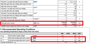

Does DRV8718 have GHx or GLx short to GND protection? I saw that GHx/GLx gate drive current is internally limited from datasheet. Does it mean that it will not be damaged if GHx/GLx short to GND?

    We may discuss not the same thing. I would like to check with you if GHx/GLx pin have internal short to GND protection.

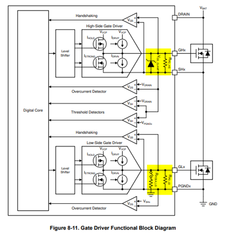

  • Hi Ethan,
    The DRV8718-Q1 does incorporate internal diode and resistors to offers a level of protection against shorts by clamping the voltage on the gate pins. It is also recommended to use external Schottky diodes and series resistors between SHx and GND, and GLx and GND for additional protection against voltage spikes and negative transients.
