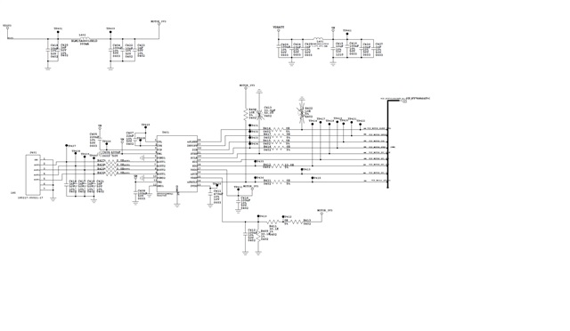

DRV8889-Q1: Schematic check of DRV8889
Part Number: DRV8889-Q1
Hi Team,
Recently, 2 pieces of DRV8889 chips have been found to be damaged, 1 piece is PIN13 damaged, and the other piece is PIN6/PIN7/PIN8/PIN9 which is a low level and cannot be pulled up. In order to improve EMC performance, we have added 1Nf capacitors to the output PIN6/PIN7/PIN8/PIN9 of DRV8889. Please help check the schematic diagram of DRV8889. Thank you!
Annie
