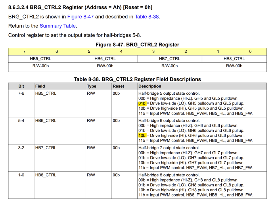

Hi team,
Customer is doing software eval of DRV8718, and below is the command
Write 87 to 0X07 (IC_CTRL1)
Write 12 to 0X08 (IC_CTRL2)
Write 12 to 0x26 (CSA_CTRL1)
Write 00 to 0X09 (BRG_CTRL1)
Write 00 to 0X0A (BRG_CTRL2)
Then they connect half bridge 5 and 6 with a 1 ohm power resistor to simulate the motor load, enable the bridge by write 60 to 0X0A, there's no voltage change. Is there any step missing?
Thank you
Scarlett
  • Hi Scarlett,
    The sequence looks okay to me. So the LS should be on in HB5 and HS should be on in HB6. What are the values read from the IC_STAT1, VDS_STAT2 and VGS_STAT2? One important point to keep in mind. 1 ohm power resistor is not a simulator for motor load although the motor may have 1 ohms DCR. BDC motor has an inductance and when the motor runs it has a lot of BEMF to reduce the inrush current. 1 ohm does not do all those. At the minimum the simulation should be a higher resistance like 10 ohms and a series inductor to simulate an equivalent running current of the motor not the starting inrush or stall current of the motor. 1 ohm will result in overcurrent and could damage the output FETs.

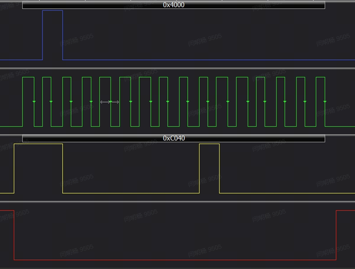

  • Hi Murugavel,
    Thanks for your support. Customer read IC_STAT3 and the result is 0XC008, so the SPI communication should be correct. VDS_STAT2 and VGS_STAT2 also normal, no OV OC. However, the IC_STAT1 returns 0XC040(bit 7 abnormal), does it mean there's SPI fault that stops DRV8718 output? Please see the record below
    Scarlett
  • Hi Scarlett,
    IC_STAT3 = 0xC008 read correct yes. But IC_STAT1 = 0xC040, BIT6 = 1 which means POR has happened. This is normal behavior, the first time device is powered up POR bit will be set. I don't see any other error happening. The device responses looks right.
    After writing 0x87 to 0X07 (IC_CTRL1) which issues a CLR_FLT the POR bit in IC_STAT1 will clear. This can be verified.
