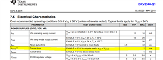

Hi team,
How much delay time from completing reset pulse input (consists of a high-to-low-to-high transition on the ENABLE pin) to operation state? Is it 1msmax? If yes, do you have minmum time spec for that?

Hi Ochi,
We do not have a minimum spec for this, tWAKE could be as low as 200us but the customer should assume the max value since this is a wait time and the device may not be ready until the full 1ms has elapsed.
