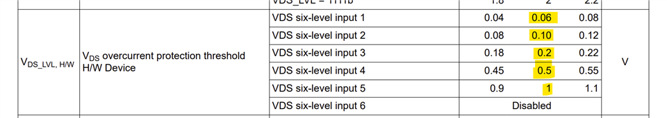

I am using the hardware version of this chip.  I have a board built and successfully running brushed motors.  I did my calculations for the various control resistors based on 100A max.  I currently have the overcurrent protection disabled (pin 4 VDS tied to DVDD) because I couldn't figure out how to set the resistor divider to feed the overcurrent control pin 4.  I couldn't make out what the Level 1-5 meant in terms of max current.
Can someone please advise?
Ideally, I want to set it to kick in around 70 or 80A.  But I still want to understand what each level would represent if the calculations were based on 100A.

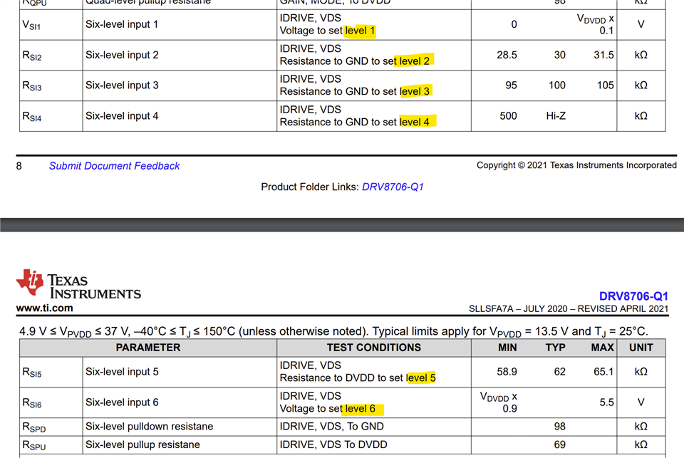

    The VDS levels highlighted in the below snippet are selected based on the level voltages (resistors to GND) suggested for this 6-level input pin, shown in the second snippet.
    VDS voltage is the I*R voltage drop across the MOSFET, which would be load current * Rdson of the FET. Let's say the Rdson of the FET is 10 mΩ, with 100 A the VDS voltage would be 100 * 0.010 = 1V. So VDS pin should be set for level 5. I hope this helps.

  • 1) When I looked at the EVM board and schematic, they just ground the Vds pin for Level 1. But the datasheet shows 0.04V to 0.08V.
    2) Also, if I solve for Current limit thresholds when RdsON = 1mOhm nominal for my MOSFETs
    I get
    Current Limit Equation Rdson (Ohms) Level (Voltage nominal) Level number
    60 Icurrentlimit = Vdslevel/Rdson 0.001 0.06 1
    100 0.1 2
    200 0.2 3
    500 0.5 4
    1000 1 5
    Disabled DVDD (3.3V in my case) 6
    That means that in my case, the best I can do is either set the limit to 60A or 100A.  That means this feature would become useless if I had an even lower RdsON MOSFET.  Or am I missing something?
  • Hi Craig,
    VDS threshold 0.06 V typical is the lowest available threshold in this device. Hence that was selected in the EVM. You are correct with the calculations. 0.06 V threshold may not be the best lowest threshold for ultralow Rdson FETs if you want to detect lower than 100 A threshold for OC. Ultralow Rdson FETs are also meant for super high inrush currents and they'd survive very high pulsed current, 100's of A. Ideally a latched overcurrent fault should be used with such low Rdson FETs.
    See below absolute maximum ratings of the FETs used in the EVM hardware.
