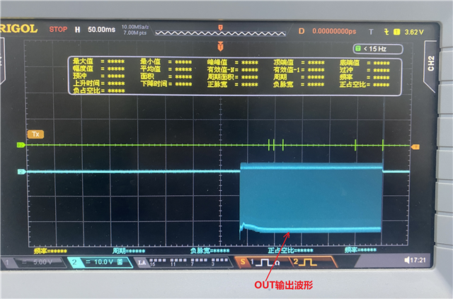

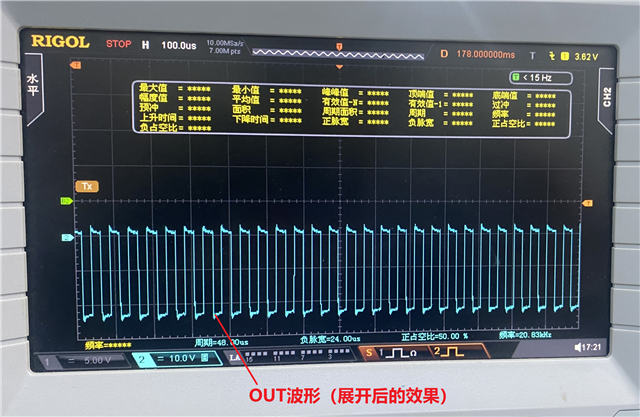

The input terminals IN1 and IN2 of DRV8871 input static data. For example, IN1=1 (high level), IN2=0 (low level), the duration is 200ms, then IN1=0, IN2=0, and the period is 2 seconds. It is found that the OUT1 and OUT2 outputs of DRV8871 are PWM waveforms with a duty cycle of 50% and a duration of 200ms (the same duration as IN1=1 and IN2=0). Why is the OUT output PWM instead of a continuous fixed level?

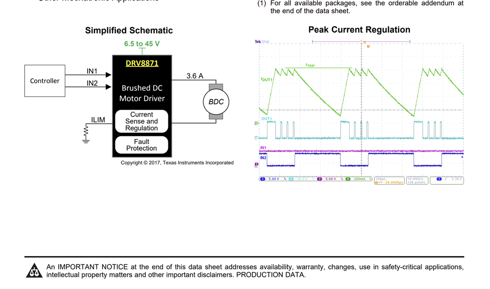

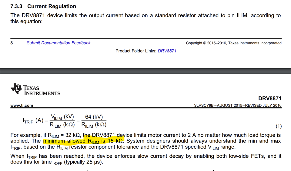

    It appears that peak current regulation was kicking in. Did the customer try with RLIM = 15 kΩ ? Having the ILIM set to 64/15 = 4.27 A should not kick-in regulation assuming the solenoid current does not exceed 4.27 A. What value of the RLIM was used? Can you share the output current waveforms when the solenoid is enabled from rising edge to steady state current?

    This is the voltage waveform. Can we get current waveform using a current probe? Can the customer try with 15 kΩ? What is the specifications of the solenoid DCR and inductance?

    The DC regulated power supply outputs +24V 1.4A to power the DRV8871. When soldering RLIM to 15kΩ, the OUT output is high level (no longer a PWM waveform).

    Sorry I'm trying to understand exact details. Can you please post input and output waveforms for both 30k and 15k RLIM cases. If no AC probe customer can use a power resistor like two or three 1 ohms in parallel and capture the voltage across it. Note the ground of the probe should be isolated and not conflict with other channel ground input of the scope.

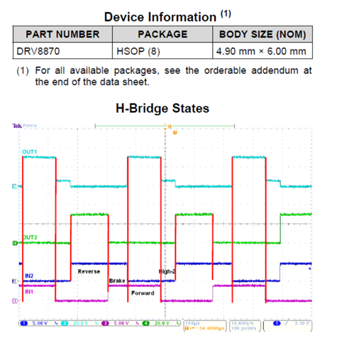

    2. The final comment was "Assuming the voltage and current requirements can be met with the DRV8871/2, it should be able to control a bistable latching solenoid.". But there was no closure with why it was not in the selection guide. In general as long as the voltage and current drive requirements match it should work.
    3. The difference would be the current regulation scheme. See below. This requires external current sensing resistor vs. Rlim resistor on the DRV8871. Customer can use the DRV8870 if they prefer to use it. If current regulation is not required the Rsense can be a short or 0 ohms and connect VREF to 3.3V or 5V. The current will be limited by the electromagnet DCR, 8 ohms, so 3 A.
    Regarding the electromagnet, 24V and 8 ohms will mean a steady state load current of 24/8 = 3 A. The customer power supply should be capable of providing > 3A without significant decrease in 24 V (ripple voltage). For the DRV8871 Rlim 15 k would mean 64/15 = 4.3 A, so there won't be current regulation. I'm not sure what caused abnormal waveform. Can we get input and output waveform taken with two channels?
