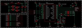

Hi, I have DRV8452PWP (HWinterface, not SPI)
but when I connect the board to waveform generator, it goes like one pulse = one step of motor, that would be fine if i would set it to 1/1 microstepping (as I understood datasheet), but I have set some microstepping (before powering it up) but nothing changed. Motor steps are pretty hard so it must be 1/1 stepping. If i try to short some of M0/M1 to ground while motor is runnig, there is no difference.
Im using NEMA23 at 24V (SY57STH76-2804A)

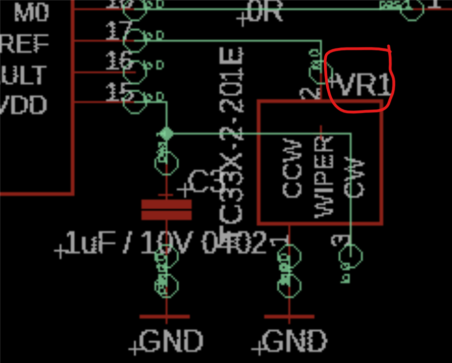

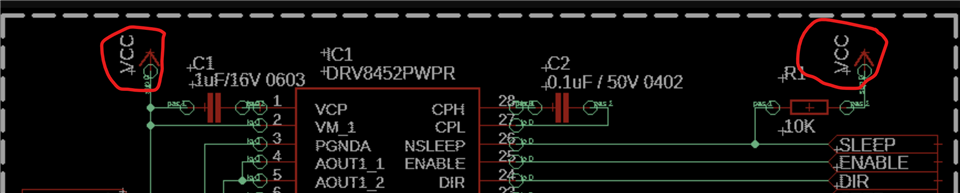

Here is my schematic: (just prototype)
I have measured the voltage in pins of DRV8452 directly, and it was correct, if I connected them to DVDD or GND, there was 5V and 0V respectively.

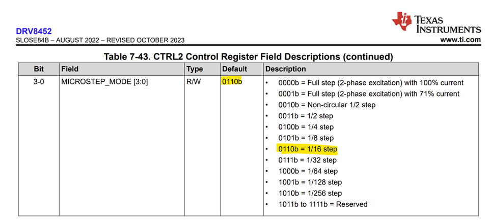

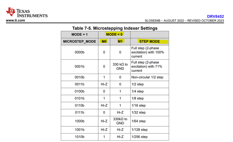

In datasheet I found this:
So HWinterface supports microstepping, do I have to enable it somehow?
Thank you for helping me.
Have a great day
Ondra
  • Hi Ondra,

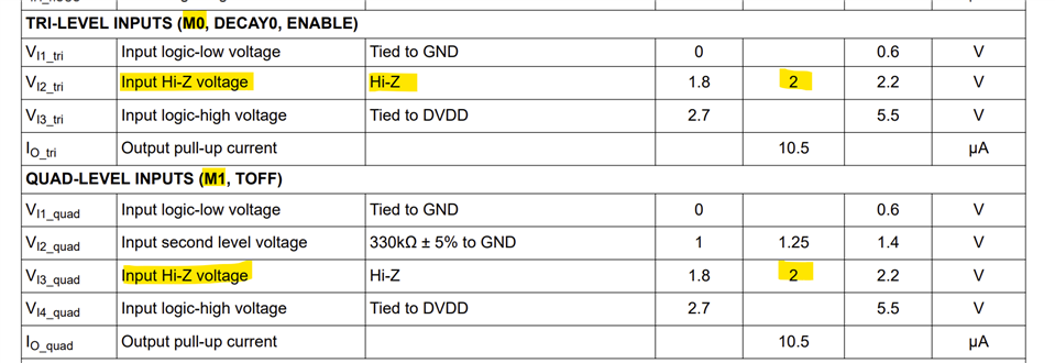

    While using HW interface for the DRV8452 microstepping is set with M0 and M1 pins. Auto microstepping (interpolation) feature is available via SPI only. Please see below for M0 and M1 setting table from the datasheet.
    Regards, Murugavel
  • Hi Murugavel,
    Im familiar with the table you send in reply, correct me if Im wrong, since I have PWP package and  HW-interface,
    there is not MODE pin, so i dont care about its state.
    When I tried to set some microstepping, for example (as it was the easiest for me, since the schematic is as is..) I leave both M0 and M1 unconnected = Hi-Z
    (is it correct?) I understand Hi-Z as Hi imedance - so its open circuit.. unconnected...
    Nothing changed...  It still went like one pulse =one step of motor
    I tried to connect "1"  so DVDD, and on pis was 5.0V  and  nothing changed...
    I know, my schematic is simple, but is it correct?
    There are no protections, no isolation...
    I just wanted to test this driver on signal generator, If it fits my case and than I would make much better circuitry around the IC.

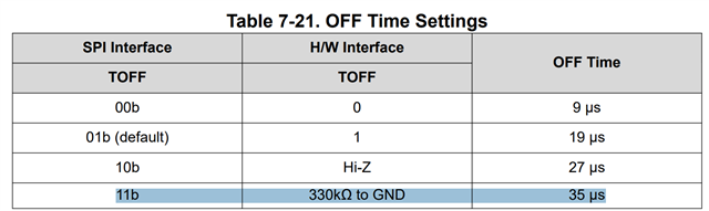

  • Hi Ondra,
    You're correct with PWP package there is no MODE pin and the DRV8452PWPR orderable device will be a fixed HW mode option. For this device if M0 and M1 are left floating (Hi-Z) we expect the device to be in 1/128 uStep mode. I don't see anything unusual with the schematic. You can measure the voltage on M0 and M1 to make sure they are in compliance with the datasheet and verify they are in truly the expected mode.
    If these check out okay it will be a good idea to replace the device and test again. Sorry you are facing this issue. I have not tested the DRV8452 but I have tested the DRV8462 in HW mode and seen it work as expected for microstep settings. DRV8452 should behave similar.

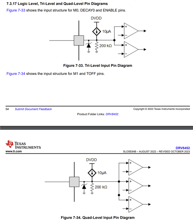

    One thing I remember when I was troubleshooting with that driver, was that actually, when I left the M0 or M1 in Hi-Z,
    I was able to measure there only cca 1.6mV, that surprised me, but now, when I have my eyes on that table again, I see a problem there.
    Another thing is, when I connected there DVDD or GND, I measured 5V and 0.0mV respectively, (looks like pins are internally not connected? but then why the logic stays on logic zeros on both, and goes 1/1microstepping?) I dont know..

  • Hi Ondra,
    These pins have high input resistance, you can see a low constant current source and a 200 kΩ pulldown resistor on them. You're correct when it is close to 0 V on M0 and M1, FS 100% IFS is selected.
    I think I may have caught the issue on your PCB. What is the value of the VR1? If I read correctly, TC33X-2-201E is a 200 Ω potentiometer. This is severely loading the DVDD output. 5/200 = 25 mA. The internal LDO can deliver just a few mA and not intended for external loads other than pullups (≥ 10 kΩ) and properly sized VREF potential divider again ≥ 10 kΩ, I'd suggest a 22 or 47 kΩ potentiometer. DVDD must measure 5 V (assuming VM = 24V) for proper operation of the device. Please change this potentiometer. I think this will fix the issue for you.
    Regards, Murugavel
  • Hi Murugavel,
    You are correct, the potentiometer in schematic would be wrong, but I used this one just because of the package, I has some simillar looking variable resistor here so I used it insted of the one in schematic, again, it was just because of pad layout. In reality, on this place is 20kOhm potentiometer
    even the current can be set without a problem.  (DVDD is very stable and precisely holding on 5.02V)

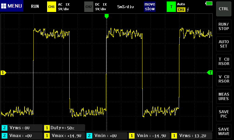

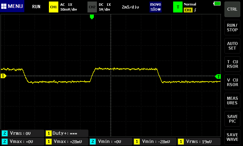

    I have here some images of current on one of the coils:
    first image is with 0.1 Ohm resistor in series with the coil,                                    and the second image is with 47Ohm power resistor:

  • Im really sorry for that mistake in schematic.
    Schematic should be clear.. I know
    Im sorry for that..

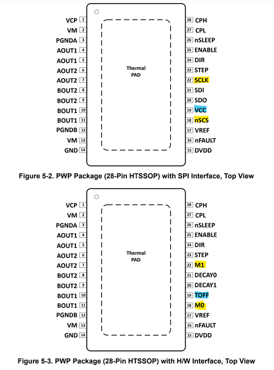

    I unsoldered the potentiometer and nothing changed, but than I was just measuring around, I found some Interesting (at least for me) fact,
    that is.. when I left M0 floating, I measured 4.93V there! I believe there should be something around 2V. (if left floating)
    I didnt know where from it came there, but (since it is M0 pin) I tried to short it to ground, and my powersupply has shown around 30mA increase in current, motor was not spinning, just holding and current was left floating (i know it is not good idea), powersupply shown nearly zero, so there was not set current in to coils of motor.

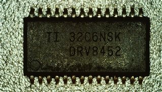

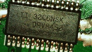

    Since I ordered these ICs as a samples, the marking is a little different and I wonder if someone just didnt marked this chip only as in general DRV8452

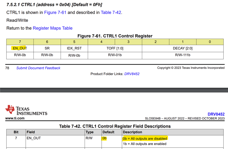

    Simply said: my idea is, that this IC is actually SPI version...
    What do you think about it? could this be real?

  • There is one more small change not in schematic and thats around TOFF pin:
    I have there 330K to GND resistor (in schematic there is 0R...)

  • Hi Ondra,
    Sorry to hear changing the issue did not resolve your issue. Are the IC marked DRV8452? No "S" suffix and on the shipping box as well? Your observation of 5V on M0 pin is mysterious considering an "S" device. See below. The SCLK and nSCS are inputs. Vcc pin sets the logic high level output at SDO pin for the S device. In the H device that's TOFF which is connected to GND in your schematic, so no chance of an SDO output which could be connected to GND because you have DECAY1 to GND.
    Can we do another experiment? Try lifting up the M0 and M1 pins from the PCB and leave them floating and perform a test. If the M0 still measures 5V and have same behavior please stop all further tests. We'll sample a DRV8452H device and try to reproduce the functionality of M0 and M1. Sorry this debug is taking longer than we'd like it to.
    Regards, Murugavel
  • Hi Ondra,
    Just pushed the reply button. But 330k to GND rules out any grounding of a potential SDO pin. If you could isolate M0 and M1 that will definitely let us know what is going on. Thank you.
    Regards, Murugavel

    Just measured it and I wanna say: Only SJ3 in my schematic is shorted, others I left floating.
    On M0 pin was still 4.93V  (same as DVDD)
    On DECAY0 and M1 was something around 0.7mV and 1.3mV respectively.
    So what would you say? does it correspond to SPI device?

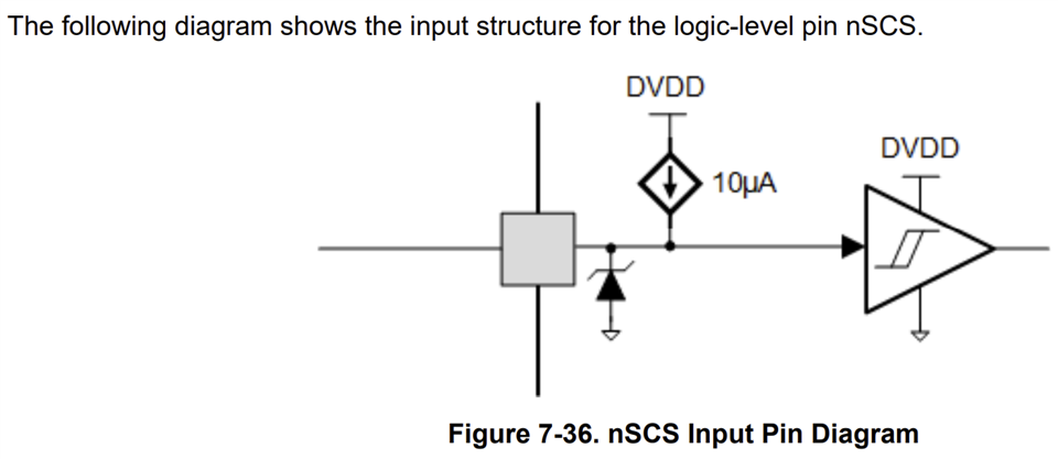

  • There are some photos:       these are samples, so their marking can differ from normal ICs
  • Hi Ondra,
    If M0 measures 5 V same as VDD I have a strong suspicion it may be the nSCS pin of the SPI device. However the unexpected behavior is what you observed when shorting that pin to GND. It should not load the DVDD because the pin is biased from a weak current source. That indicates some other possible failure.
    Thank you for the images of the device. I'll verify with the database. Meanwhile I'm going to sample some DRV8452PWP devices and test in our lab. Thank you very much for your patience.
    Regards, Murugavel

    Thanks for the additional info. VREF to GND should not cause this behavior. That'll make the coil current close to 0. Anyways an M0 pin not reading 2V is suspicious. From that standpoint we know what the issue is regarding microstep setting. But another unsettling issue is even if we assume SPI device the default microstep mode is not full-step mode. It should be 1/16. So I'd not want you to waste trying an SPI communication. Two devices damaged back to back while handling has a very low likelihood, but I've seen it happen.
    And also the output H-bridges would be disabled by default.

    I also verified the factory code on the device image you shared in your post. They checked out to be correct DRV8452 hardware version devices.
    This only adds more to the mystery of the issue you were seeing, unfortunately. Perhaps you can double check your hardware one more time and as a contingency backup order a new set of the DRV8452PWP samples for further testing. Having a DRV8434EVM would be helpful but not really necessary.

    TOFF: 35uS - 330K to GND     (Current Ripple: 25mA + 6% Itrip)

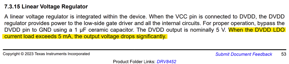

    I found a potential issue in your schematic looking at it one more time thoroughly. I think this escaped my attention last time because of the netlist labeling. Usually Vcc netlist label is used for low voltage such as MCU domain 3.3 V or 5 V. VM netlist label is used for the motor power supply, connected to the VM pin-2 and pin-13 of the DRV8452. In your schematic I found VCC used for 24 V motor supply. The nLSEEP pin is also pulled high to this 24 V motor supply VCC. The nSLEEP pin absolute maximum is same as the VM voltage so connecting it to 24 V electrically not affect the pin longevity. All other control pins must not exceed 5.75 V though.
    I see the nSLEEP is also connected to the MCU control GPIO so this voltage could potentially affect the MCU. Usually we connect the nSLEEP to the same GPIO voltage domain as the MCU for logic HIGH. This is how it is in the EVM. Could you please try removing R1 10k and setting the nSLEEP pin high with the MCU GPIO? Not sure what was the voltage on the nSLEEP pin with this resistor and also pulled high to MCU voltage domain with the GPIO control.

  • Hi Murugavel,
    At first, you hit the right spot, everithing is solved now Smiley
    Since I started to control nSLEEP pin directly with logic voltage, it worked as it should.
    I just would like to say, It was pulled up to VCC, because I hadnt another powersupply on board, so I went through datasheet and I saw it has max voltage VM, so I was thinking its not a problem...
    Beacause it is meant to be an industrial driver, on prototype I had only 24V and logic inputs from external devices...
    Now I have modified sine wave on coil current as it should be.
    Thank you very much Murugavel, I dont think I would find this issue...
