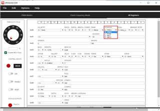

In the GUI of the DRV8308EVM,
I want to set "SPDMODE" in the All Registers tab to "0 - FREQ".
However, after I do this, it returns to the "Control Mode Select" setting on the PWM Modes tab.
How can I set the Closed-loop Clock Frequency Mode?

Hello Hyoshino,
Please try using the latest GUI on dev.ti.com:
https://dev.ti.com/gallery/view/4993501/DRV8308_EVM/ver/1.0.1/
Joshua
