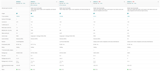

  • Hey Joel,
    Agreed that it would be nice if our datasheet had this data.  Unfortunately the best I can give you is another E2E post answered by someone more familiar with this part - https://e2e.ti.com/support/motor-drivers-group/motor-drivers/f/motor-drivers-forum/1015206/drv8832-pwm-frequency-tolerance This part is very old so we don't have any plans to update the datasheet at this time, though I will look into it.
    You mention this is a new design - the DRV8832 is a very old part, and we have many newer devices with updated features (and improved datasheets) that might better fit your application.  Can you take a look at the DRV8214? It works up to 11V / 4A (compared to DRV8832 7V / 1A), has internal PWM generation at selectable 25kHz or 50kHz, and is in a much smaller package size than DRV8832.  DRV8213 is a similar, cheaper alternative if you don't need the advanced features in DRV8214 such as speed/voltage regulation, position control, or internal PWM generation.
