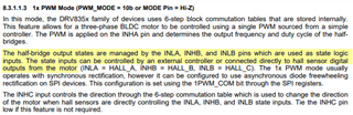

Hi support team.
My customer is considering BLDC motor system with sinusoidal control by using hall sensor.
They asked us about sinusoidal drive with DRV8323R on 1xPWM mode.
Is it possible to construct system with DRV8353 on 1xPWM mode which BLDC motor is controlled by sinusoidal by using hall sensor?
-Sinusoidal BLDC motor drive system
MCU(1ch PWM output -> DRV8323R(1xPWM mode)->BLDC motor(w/hall sensor)
