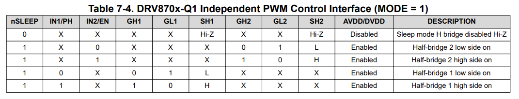

  • Hi Jason,
    It sounds like you are looking for independent half-bridge control. Unfortunately, the DRV8701 doesn't have an independent half-bridge control mode, only PWM or PH/EN. I would recommend looking at the DRV8702-Q1, which has the same functionality as the DRV8701 but does have independent control mode. Another option would be one of our new gate driver designs, the DRV8706-Q1 which also features independent half-bridge mode and a Split HS and LS Solenoid Control Mode.

  • HI David,
    Thank you for the response, but I don't see how independent half-bridge interface helps.
    It looks like from this table that if IN1/PH is 0 or 1 then IN2/EN is a don't care and I can't drive GH2 or GL2.  Hopefully, I'm just interpreting this table wrong.
    The end goal here is to be able to drive a single Brushed DC motor in two directions with PWM >= 15KHz.   Is the DRV8701 suited for that or not?

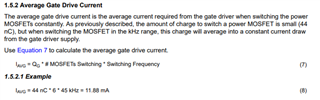

  • Hi Jason,
    Do these issues still occur when IDRIVE is increased?
    Please see the attached application note on Understanding Smart Gate Drive to better understand the gate current and frequency relationship.
    Use the calculation below to calculate the required gate current.
    If you don't already I would suggest testing on one of our Evaluation Modules (DRV8701EVM)  for easy design testing.
    David
  • Hi David,
    I put 68K to AVDD (strongest drive strength) and the problem still exists.  The rise time in this mode is 140ns.  With IDrive floating, I get a rise time of 202ns.  Of course, I also don't have an active probe so there's also a 10pF load for the probe so this is likely slowing down the signal somewhat.  I had already worked the calculations for IDrive.  For these FETs (Infineon PN: IAUC100N04S6L025)  the total gate charge is 25nC and 5.1nC Qgd.  Given these calculations at 15.625KHz my IDrive should be in the 34 to 51mA range.  A source and sink of 100/200 should yield 51ns rise and 26ns fall.  Again, I'm not sure what the /true/ rise time is since my scope probe has 10pF load.

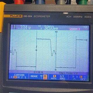

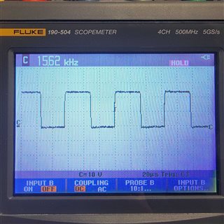

  • Hi David,
    After conversing with a long time mentor of mine, I have found the reason why the motor is behaving in this strange manner.  The issue is that PWM on IN1 while IN2 is low, controls the gate to GH1 and GL2.  The fact that both are turning on/off at the same time shows a motor waveform like the following.
    This is a scope shot taken at the terminals of the DC motor running at 15KHz PWM 50% duty cycle.  You'll notice that there is a positive and an almost equal  negative component.  If you take the RMS of this, you'll see that there is enough to move the motor slowly in the negative direction based on how the scope terminals are connected.
    Conversely, The VNH5019, shows zero negative voltage as shown below.
    The RMS of this is very positive (based on how the scope probe is connected) and allows the motor to run at roughly 50% power.
    The reason the DRV8701 works better at lower frequencies is simply the on time of the positive pulse, but also that the short time of the negative pulse  which "recovers" significantly over the extra time between pulses.   This allows the RMS of the waveform to be more positive as shown in the scope capture below at 1KHz PWM 50% duty cycle.  You can see a negative shoot, but you also see a long recovery.  The RMS of this waveform is about 10V.
    That said, this part will not work for my application.  You were right, I need 2 independent half bridges to accomplish what I need.  I need to be able to hold either the high or low side steady, and PWM the other side.  This is the only way to get the RMS offset I need to drive this motor correctly.
