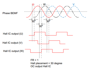

I'm driving a BLDC motor with a DRV140970EVM. When FR=1, the motor rotational speed at a max of 6800 rpm. When FR=0, the motor rotational speed at a max of 6000 rpm. What is the reason of this?

Is this fan motor? Is it seeing lower load in other direction and hence able to spin at higher speed? Can you check current drawn in either direction?

This is not a fan. The phase currents are not the same when the motor rotates in different diractions. The motor operates without load. When we use this motor with another motor driver, it rotates at the same speed in both directions and the phase currents are the same.
Hi Cem Zorlu,
Looks like CMTMOD issue, can you check DAA pin status, CMTMOD and what is preferred for your motor?
Also, is it Trapezoidal or Sinusoidal?
Please test with different CMTMOD and let me know how it works?

Hi Venkatadri,
Pins status:
CMTMOD LOW, DAA Floating, BRKMOD HIGH -----> EVM board works best in this pin state. Power consumption 0.8W.
When CMTMOD changes, it does not rotate correctly and consumes too much power. (CMTMOD HIGH >12W, CMTMOD Floating 7W)

We need to check if there is any other issue, without load 12W or 8W is too high. Let me check and get back to you.

We looked at the phases of the motor and hall sensor outputs with an oscilloscope. Hall sensors were the oppsite of the hall signals seen in the photo below. The problem was solved when we removed the hall sensors from the positve pins and plugged them into the negative pins.
Thank you for your support.
