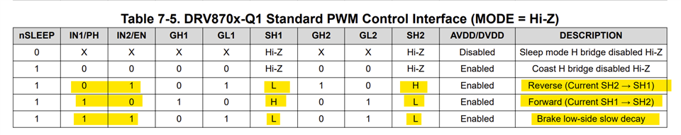

  • Hi Huan,
    Thank you for posting in this forum. In order for the device to power up in PWM input H-bridge mode the MODE pins must be HiZ while nSLEEP = 0 and transitions to 1. Then, when nSLEEP = 1 the device wakes up and latches the MODE status (input HiZ) to PWM input H-bridge mode. In this mode of bridge control as shown in Table 7-5, one of the inputs must be HIGH (IN1) and the other input (IN2) must be input with a PWM input with variable duty cycle to vary the speed of the BDC motor at the output. When IN2 is HIGH and IN1 is input with PWM the motor will spin in the opposite direction. What is the input PWM frequency and duty cycle provided to the input during the tests?
    When PWM input = 0 the motor will be driven. When PWM input = 1, both IN1 and IN2 will be HIGH resulting in low side FET slow decay of the current in the motor winding. This process happens for every PWM on/off period. The motor can be driven with 100 % speed without using a PWM input and instead making one of the inputs LOW while the other input is HIGH.

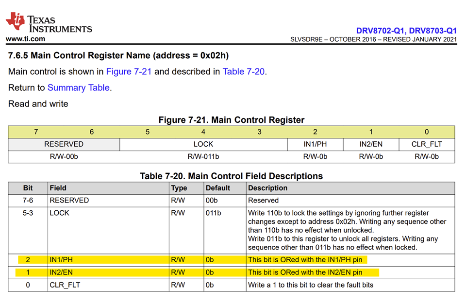

    You can use the below highlighted bits in the Main Control Register to run the motor at full on or full off. Because there will be no PWM or soft start you should configure current regulation to limit the startup inrush current if need be.

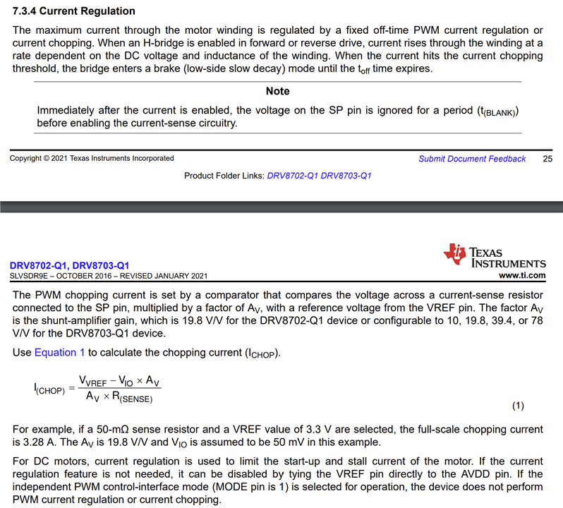

    This section of the datasheet discusses current regulation - see below.
    Regards, Murugavel

    Maybe I seem to understand:If I want to configure IN1 and IN2, I can externally pull IN1 and IN2 up and down, or I also can use SPI communication to write Main Control Register. Both of these methods can achieve motor drive.(Correct me if I'm wrong)

    "Maybe I seem to understand: If I want to configure IN1 and IN2, I can externally pull IN1 and IN2 up and down, or I also can use SPI communication to write Main Control Register. Both of these methods can achieve motor drive.". This is correct. The pin input is in logical -OR- with the SPI corresponding input bit.

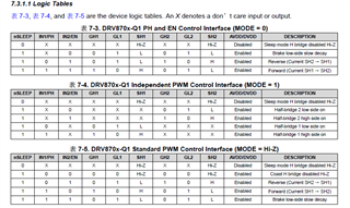

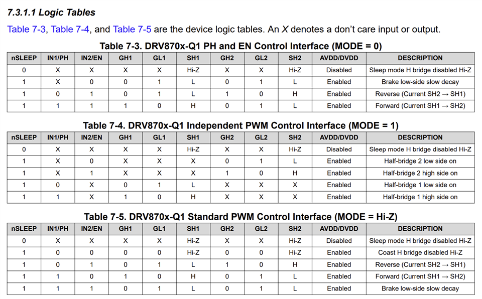

    "what PH or EN mean(IN1/PH,IN2/EN)". See below Logic tables for bridge control. The device supports three operating modes. One of them is independent half-bridge PWM input control mode. This is for using the two half-bridges individually controlled.
    The remaining two modes support full-bridge operation.
    PH and EN control mode: This is commonly used mode for bidirectional BDC motor control known as Phase and Enable control. PH pin is used for changing the direction and EN pin is used for PWM input. The advantage of this mode is only one PWM input is needed on one pin EN to control the speed of the motor in both directions of operation. You may notice during PWM tOFF and when EN = 0 the recirculation current will flow via the low side FETs, SH1 and SH2 = LOW per the table. Internal current regulation will be supported in this mode. There is also no coasting option in this mode. nSLEEP can render the bridge Hi-Z though.
    PWM control mode: In this mode the pins assume IN1 and IN2, two PWM inputs. For direction1 PWM input should be provided to IN1 and for direction2  PWM input should be provided to IN2. For direction1 and 2 if the non-PWM INx = 1, the bridge output will be active during PWM tOFF and during tON period recirculation current will flow via low side FETs. The load will not be driven while IN1 = IN2 = 1. The load behavior will be similar to PH/EN mode because in this mode recirculation happens in LS-FET. The difference is PWM input has to be on two separate pins IN1 and IN2 and duty cycle will be inverted, PWM tON bridge in current recirculation and tOFF bridge active driving the load. Internal current regulation will be supported in this mode.
    In this PWM control mode when IN1 = IN2 = L the H-bridge will be in coasting mode (HI-Z). In this mode if the motor terminal voltage from back EMF (when the motor drive is stopped instantly while running at full speed by making IN1 = IN2 =0) or by manually driving the motor via its gear train - as in a door or tailgate, is higher than VM there will be current flowing into the power supply via the body diodes of the FETs. Depending on the bulk capacitance on VM and the power supply design there could be temporary VM voltage pumping and the VM voltage may increase for a short duration. It is possible VM could increase to higher than absolute maximum voltage ratings of the driver and/or the FETs and damage it permanently. For this control mode the load will be driven during PWM tON period and coast during tOFF period. This mode is not suitable for internal current regulation because current recirculation slow decay will be absent. In this mode the motor may run faster for the same PWM duty cycle compared to the recirculation based drive modes.
