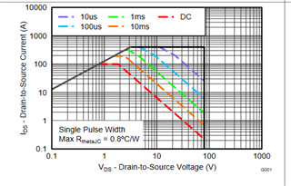

  • Hi john,
    thanks for your input..
    i need some clarification from input below mentioned that point.
    how to relate below attached graph to (In order to support 180A continuous, you would need to parallel 6 x CSD19502Q5B FETs) in this point
  • Above attached graph took from this part number CSD19502Q5B
  • Hi Prema,
    My recommendation for paralleling 6 FETs is based on the calculated conduction (I² x Rds(on)) loss. I rechecked my analysis and I was mistaken about the number of parallel FETs required. If you use the lowest on resistance FET, CSD19506KTT, I would recommend 6 FETs in parallel (30A/FET) which equates to about 2.64W/FET. This package can dissipate a max of about 4W. If you use the CSD19502Q5B, then I would recommend 8 - 10 FETs in parallel. With 8 FETs (22.5A/FET) the eatimated power loss per FET is about 2.85W. With 10 FETs (18A/FET) the power loss is 1.82W/FET. This package is capable of about 3W maximum power dissipation. What is your application and how is the FET being used?
