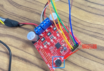

Customer just connects the BOOSTXL-DRV8323RS evaluation board to the BLDC motor without connecting the MCU. Could he make the motor rotate by rotating the encoder in the picture?

The customer will need to connect the MCU in order to properly use the EVM.

The customer wants to know what the black knob in the picture above does?

It is a Thumbwheel potentiometer, it allows for manual adjustment of an in-circuit resistance value.
