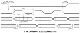

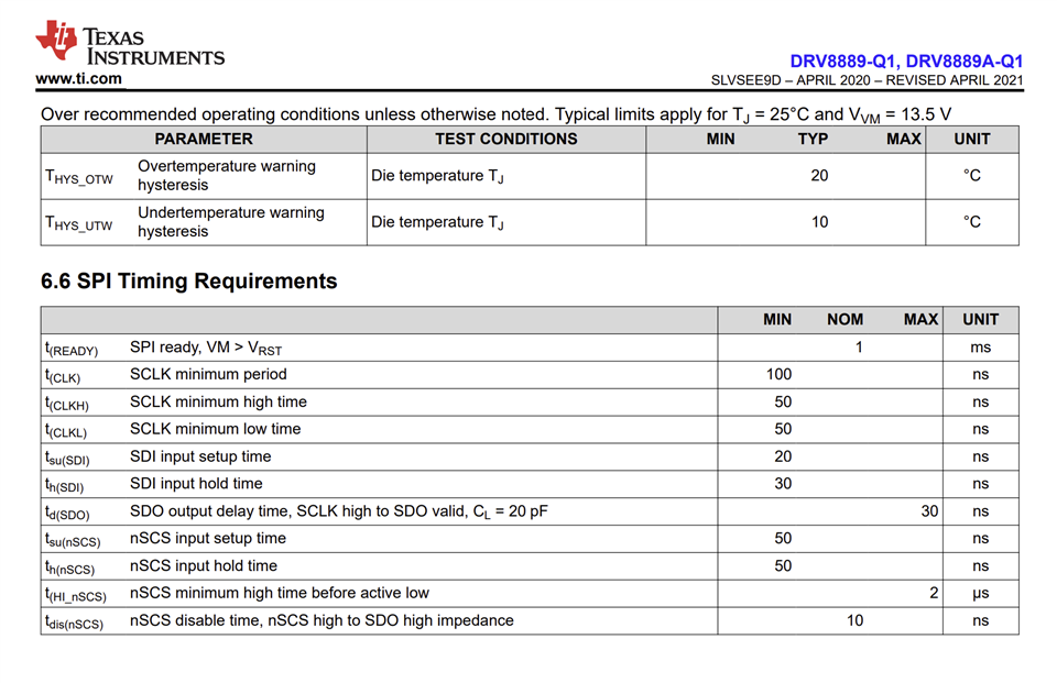

Currently using DRV8889 and need to verify the SPI timing design function.
It is necessary to ensure that t(READY), t(HI_nSCS), tdis(nSCS) are within the specifications.
Do you have any suggestion how to conduct this test?

    We have validated the specifications already and published these in the datasheet. I don't think there is a easy way to measure these parameters precisely. For example for t(READY) t0 must start as soon as VM > VRST and start doing SPI reads until you get a successful read out of a known register default value. Likewise for t(HI_nSCS) you must perform back to back SPI transactions and find at what nSCS high time the transaction fails. I have never seen any customer do this verification. Please let us know if there is a specific issue or concern that prompted this verification need. Thanks.

    1. Please see below. There is a typo in one of the specifications t(HI_nSCS), it is the MIN value not the MAX value.
    2. "VM > VRST, In datasheet it state Nom at 1ms, so if the result is more than 1ms is it possible and the result is it okay? ". Yes it is fine. Any time > 1ms.
    3. I'm not familiar with testers. I'm not sure how you can do this with a tester. t(HI_nSCS) is already specified in the datasheet. Any value > MIN parameter is okay to use in the application.
    4. You said "This is part of our new design verification for I2C". The DRV8889-Q1 does not have I2C. It is an SPI interface. All our testing performed are TI proprietary. You can establish a test protocol based on the device datasheet which is he public information we have for this device.
    If you have specific questions on the SPI we can answer. As you may have notice the MIN specification is the fastest that can be supported by the device for SPI under the recommended operating conditions of the device. Any timing higher than the MIN value or NOM value are guaranteed to work with no issues.

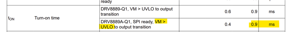

    Sorry, i have one more question. this one still relate .
    In the SPI datasheet, it states >1ms, but on the other hand, it states a maximum of 0.9ms. So, which one is correct?
    and it's hard for us to imagine this situation, because when we check this there is no information regarding t(READY)

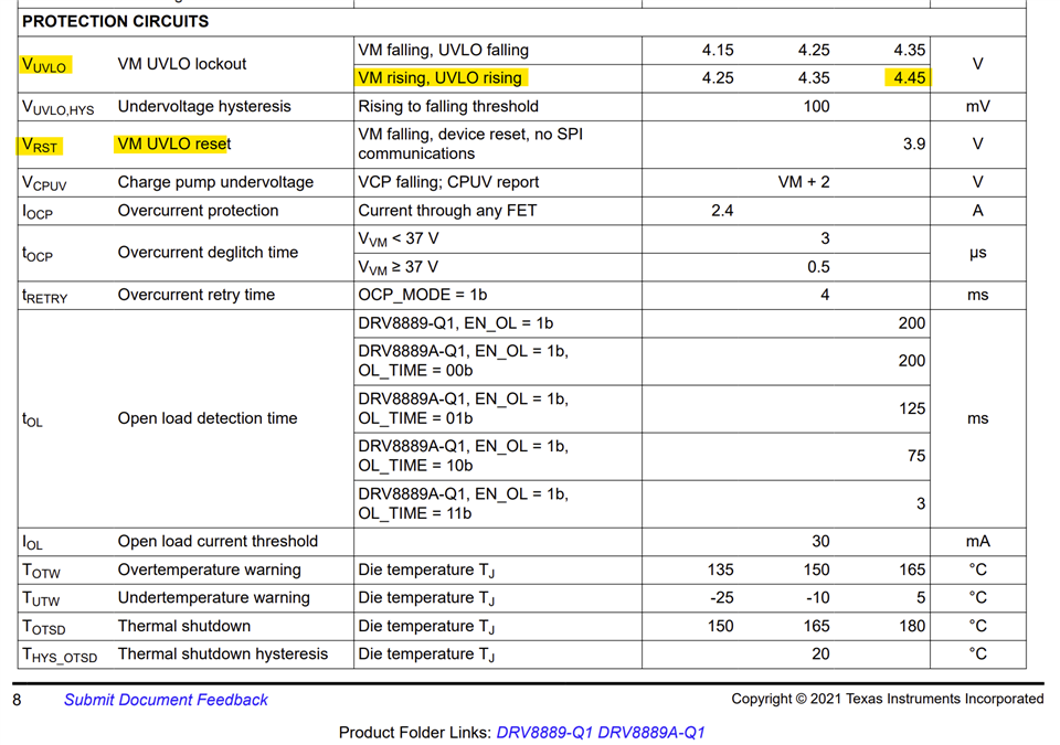

  • Oh and one more,
    Which one is the VRST Pin?
    is it DRV_off is the VRST Pin ?

  • Hi Via,
    The 0.9ms MAX is from VM > UVLO whereas the 1ms NOM is from VM > VRST. I'd consider the "time it takes from VM > UVLO here 4.45V + 0.9ms" which may amount to 1ms or little over 1ms depending on your power supply voltage ramp up time.
    VRST is VM voltage for reset. It is a VM voltage level not a pin.
