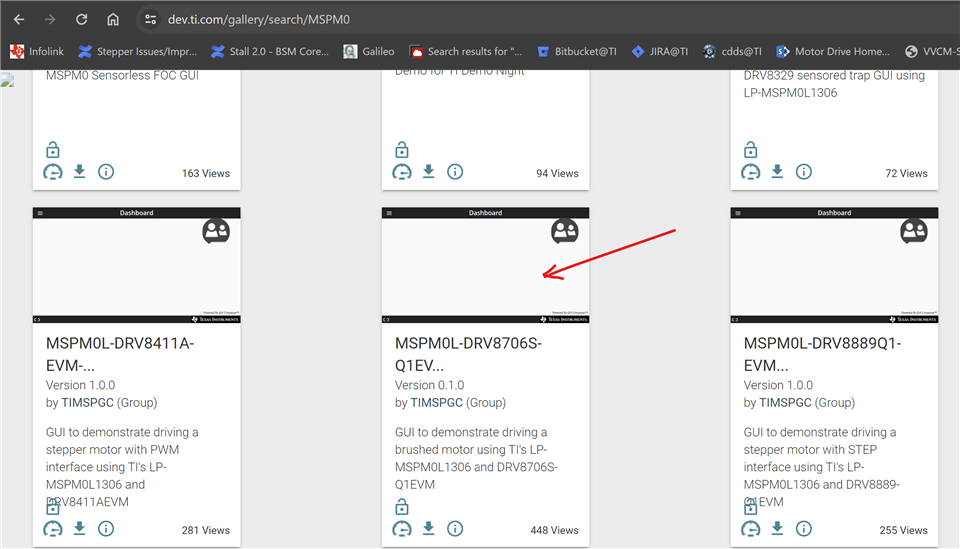

    The source code and project file with CCS for the DRV8243S-Q1LEVM can be downloaded from the EVM webpage, https://dr-download.ti.com/software-development/support-software/MD-8Fqtr3axho/01.00.00.0B/slvc821b.zip. We do not have a code example for MSPM0L1306.
    However CCS libraries based code example and GUI exist for the MSPM0L1306 for DRV8706S-Q1 which is an SPI based register controlled smart gate driver for driving BDC motors similar to the DRV8243-Q1.
    This application note describes the MSPM0 SDK for motor control including the DRV8706S-Q1, https://www.ti.com/lit/an/sprad34b/sprad34b.pdf. The MSPM0 SDK can be accessed here,  https://www.ti.com/tool/MSPM0-SDK.
