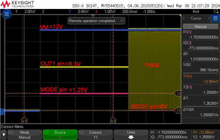

we are using the DRV8955 motor driver. We set its MODE to 330kOhm to GND (four independent High-Z, voltage on MODE_1.23V) and IN1-4 and EN1-4 pull to GND.
After that if we pull-up any one output by 1kOhm to VM=12V and on the output can be measured 6,3V. I think it should be 12V because the high-z state. On the oscilloscope all input and out pin are static state.
Do you have any idea?

    thank you for your amswer, there is the picture here:
    You can see on the picture the used settings and the external 1kOhm pull-up resistor. The driver is in the 330k to GND mode (in theory, I hope).
    On the scope image:
    Blue channel: VM voltage
    yellow channel: DRV8955 OUT1 voltage
    pink channel: DRV8955 MODE pin voltage
    You can see: if the MODE pin voltage is 1.23V, the OUT1 voltage is about 6.3V, I think i should be 12V.
    If I changed the MODE pin voltage to 0V (Mode 0), the current control is active and the OUT1 output level changed between 0V and VM, it is normal.
    I do not understand, what is this current leakage in the 330k to GND mode. I repeated this test with the DRV8955PEVM board and the result was the same.

    I just got word back from design. It looks like this voltage drop is caused by the leakage current.
    The response from design is below:
    "When the device is ON but OUT is Hi-Z the leakage is around 5.8mA nominally which means it will drop around 5.8V with a 1K resistor.
    For nsleep=0, the leakage is 1.8mA nominally.
    This leakage is present due to the strong pull downs in the high side gate taking current through diodes present between powerfet source and gate."
