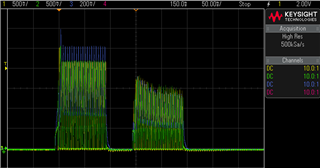

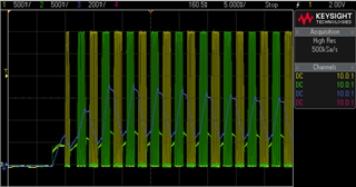

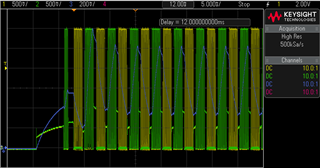

When we want to drive two haptic feedback pulses (just enable / disbale PWM), they look totally different. In the first pulse the DRV2605L outputs a much higher duty cycle for driving the LRA compared to the next pulse. This leads to a doubled current consumption and too high voltage for the LRA. We expect the DRV2605L to drive the LRA always the same (as in the second pulse). What causes the driver to behave like that? We do not feel a difference in the acceleration.
Below the two measured pulses with different zoom levels.
CH1 / CH2: OUT+ / OUT-
CH3: Signal from OUT+ filtered with RC LP-Filter (80Hz)
Zoom between first pulse / second pulse.
Startup first pulse
Startup second pulse

    1. The reason for the difference is our overdrive boost feature that is only available in closed loop mode, hence why you do not see it in open loop mode. I included a small description from the datasheet below. In overdrive, the voltage goes above the rated voltage but stays below the overdrive clamp voltage. To disable this feature in closed loop mode, you can disable the STARTUP_BOOST register.

  • Hi Sydney
    1. we already disabled the overdrive boost feature. This does not solve our problem. When I trigger the DRV2605L, it sometimes controls the LRA with a high amplitude (higher than configured), sometimes with a low one, see images below. Nothing is reconfigured in between. Attached are all the bitfields of the DRV2605L.
    CH1: IN / TRIG, generated by function generator. D=80% / 0%.
    CH2: OUT+
    CH3: Signal after 200kOhm / 10nF RC LP-Filter connected to OUT-

  • Hi Roman,
    Correcting myself from my pervious statement, turning off the startup_boost does not fully turn off the over drive functionality. This is what is causing the amplitude difference you are seeing. To effectively turn off this feature in closed loop mode, you can set the overdrive and rated voltages to the same value. Please note that the rated voltage value is in Vrms and the over drive voltage is in Vdc, so some scaling will be needed.
    As for the waveforms looking slightly different, closed loop mode is a feedback based feature, so there will be some variability.
    In general, we do not recommend having an output filter on this device as it can negatively impact the feedback features.
    Sydney Northcutt
