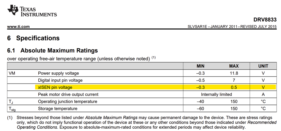

I'm trying to determine whether there is a maximum value for the overcurrent protection selection resistor R_isen.
In the datasheet for both the drv8830 and drv8832 there is mentioning of a maximum value which would indicate a minimum current to be set as the limit.
In the datasheet for the drv8830 there does not seem to be a mentioning of such a maximum value.
However, these devises seem to have a lot in common otherwise. so, just to be sure.
Is there a max value for said resistance?
Thanks in advance.

    Please use a the same range for the DRV8833 as well 0 to 1Ω. Generally the voltage range across RISEN specified must be followed. The DRV8833 can support higher peak currents compared to the other two variants so RISEN should be kept smaller to minimize voltage drop and power dissipation across RISEN.
    Is there a specific value or reason you'd want to use a > 1Ω resistor for RISEN? Thank you.

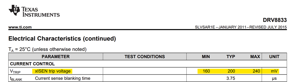

  • Thanks for your reply.
    I will not use a resistor > 1Ω.
    The reason was: I want to drive a small dc-motor with a stall current that is significantly lower than 200mA. namely 80mA.
    So that would require me to use a 2,5Ω resistor.

  • Hello Simeon,
    The conclusion was, as long as the voltage across the RISEN are within the MIN and MAX of the VTRIP specification using a > 1Ω should not cause any issues. You should be good with it if it supports your application's requirement. Please try to use as small a value the application could permit.
    Keep in mind, a short circuit situation at the output could increase the VISEN to significantly higher than absolute max specifications and permanently damage the device. Using higher RISEN increases this vulnerability. Would be good to use a current limiting power supply to avoid this situation incase of a short circuit at the output.
